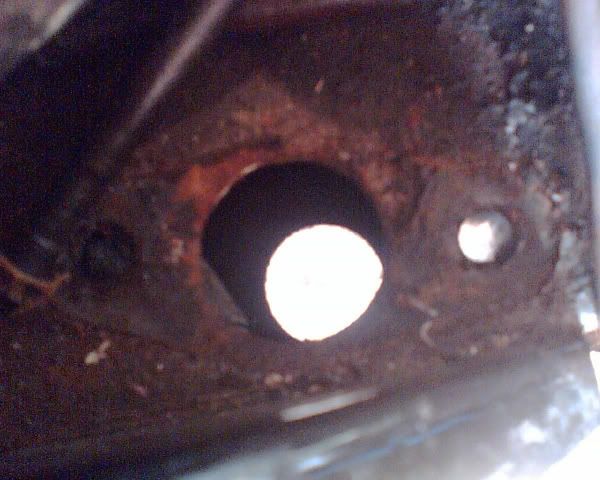

Posted 02 April 2007 - 07:19 AM
To follow up from all of the above..........
Picture (from above) of the twin bolt subframe mounting holes:
Now IIRC, the single tower bolt shells have reinforcement down the central hole, (effectively a tube welded down there), am I right on that or is my memory failing me with old age? :xxx:
Anyway, this shell is a 1971 and there is no reinforcement down that central hole, so I would not personally be happy with bolting a single tower bolt subby to it unless I had welded a reinforcing tube down there (if the later shells have them that is).

Posted 02 April 2007 - 11:08 AM
They do indeed but I think a bigger problem then welding that tube in is the toe board mounting.
Well, yeah that's a good point! It is a different shaped subby aint it! :xxx:
