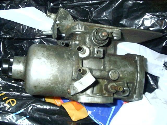

the side the air filter goes on is 48mm and the side that gose onto the inlet manifold is 47mm..if it has a square base then it is a HIF carb, you will need to measure the diameter of the carb bore to find out what type of HIF it is
