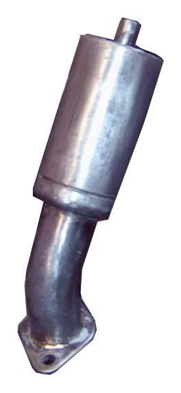

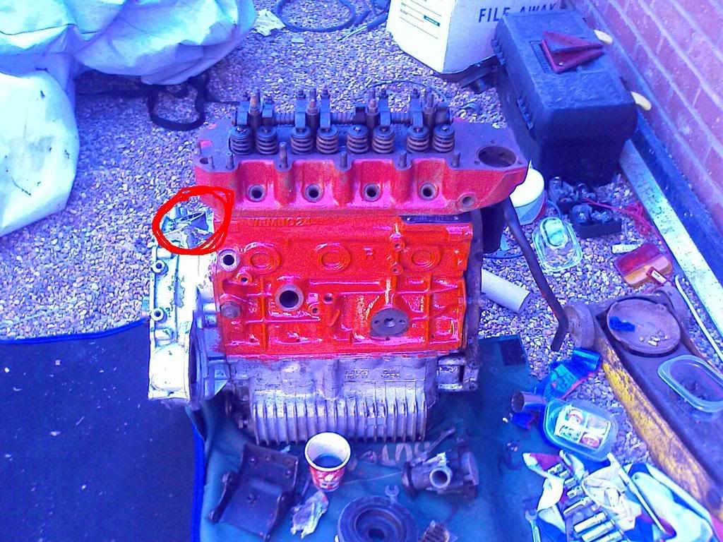

Sorry if this in the the wrong section... Basically i want to know what its called and where i can get one from, It mounts on the clutch/flywheel back cover.

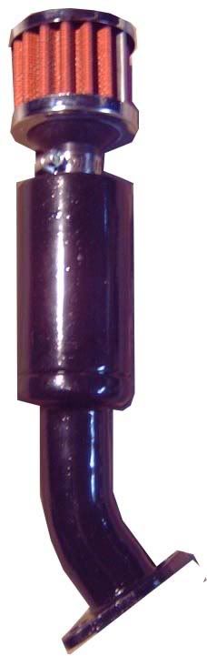

It's an engine breather canister for fitment to the transfer case on a 1275.
Be careful, there are 2 versions. One for fitment to a car without a brake servo and one for a car with a servo. Canister is at an angle if there's a servo to make sure it clears it properly.
