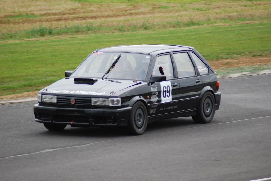

I found 2 pictures I took at Castle Coombe Mini World Action day on my PC :withstupid:
Here ye go :lol:
And so my mate could read what it said I took this one!!

Cheers for those pics, its a shame the engine gave up on the day though :thumbsup:

I saw this at Combe as well. I think I have a pic of it somewhere will have a looky. The new plans sound good anyway.
