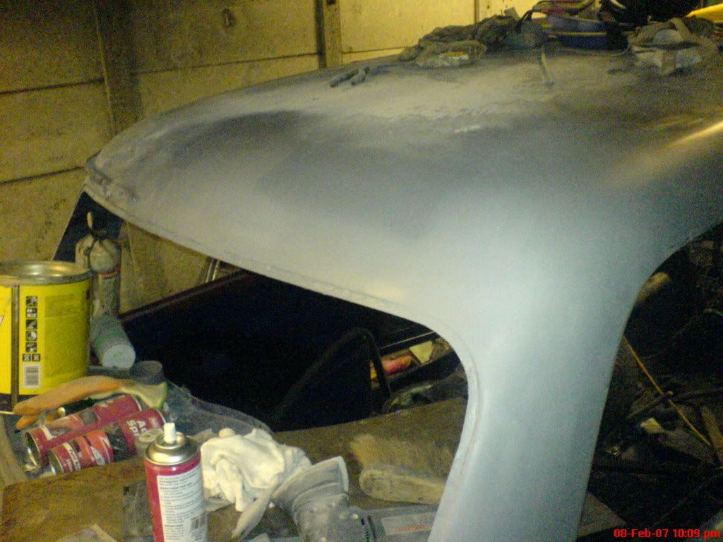

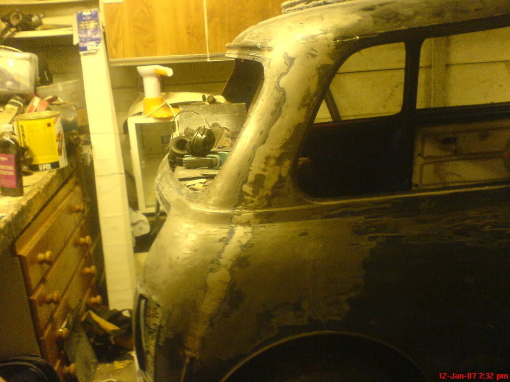

heres how i did mine!
Firstly i ran a weld up the inside of the seas where i could, i was told that this was not how you are supposed to do it but it worked fine for me, i thn cut the seams of with a 6" grinder, welded over the top again and then goround the weld back. then after that i worked with filler to give a smoother finish.
During...
After...
Although when you come to do the rear guttering i welded in a extra strip of metal as where the join from the rear window section meets the roof section as there is about 7mm of stager between the two pannels!
and it takes bloody ages!
