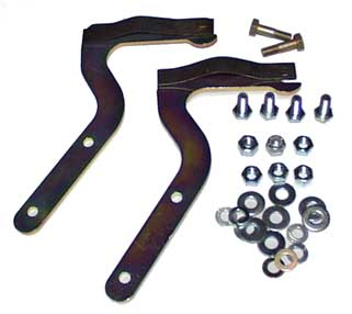

Quick search, they look like this... Just need to find somewhere in the UK, then you could pin or strap the front?
http://www.minimania...68/ArticleV.cfm ???

These hinges will fit your car
You may need to file the corner off the hinge itself where the spring steel clip slides over. Its self explanatory once you have them fitted. Fitting them however is the difficult part, there just isnt enough room to get a pair of hands un the the scuttle to tighten up the bolts :kiss:
