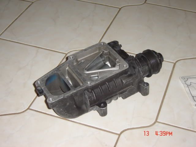

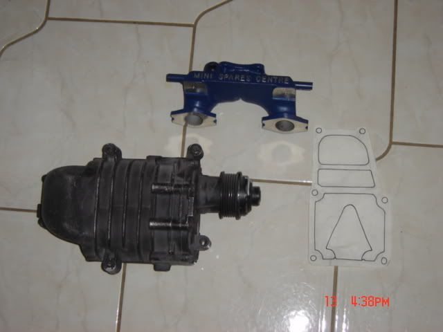

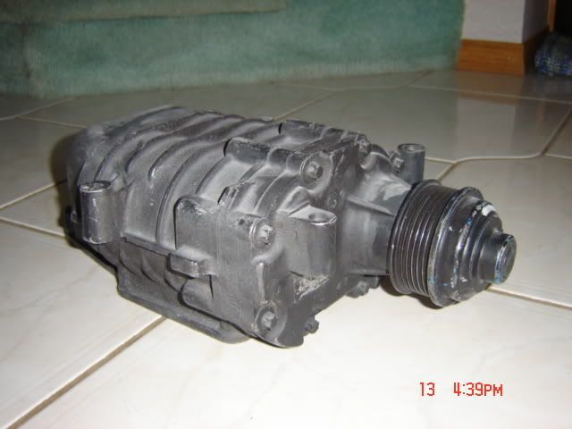

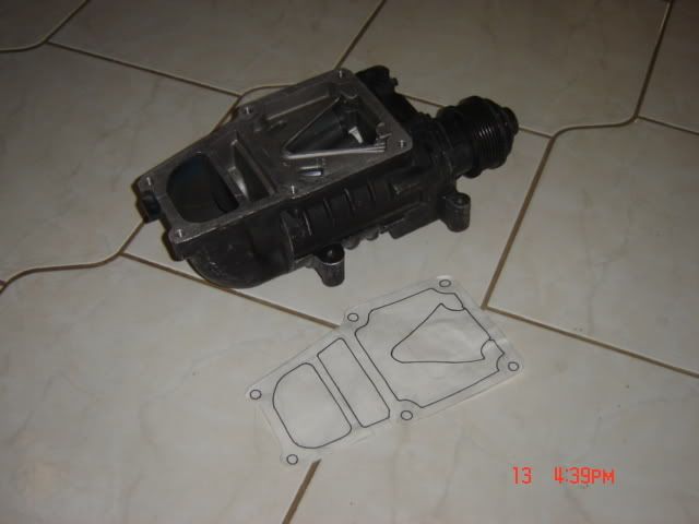

heres a couple of pics of my supercharger... shows size by being next to a mini intake manifold....
cheers,
Al

thanks a bunch for that spreadsheet andy it is really handy... so as i was searching the internet for info to help me figure out what i will have to do to this supercharger i got another twig thrown between my spokes.... it seems that this certainly isn't off of a mercedes c230 as the c230 ran an eaton m62 with a built in clutch assembly... mine is myserious for sure... i've been searching and searching trying to figure out what it could be off of and i can't find anything like it... i have no idea what this is off of... i'm gonna look a little more but i'm getting really tempted to just try and find an eaton m45 as it would be a little easier.. (still plan to fab it up myself though)
so if anyone has any clue where this supercharger is from please help!!!
thanks,
Al

it does look very similar to a eaton m45. it is easy to find a m45 in the UK. obviously not here on canada thoguh. maybe you could get one in the UK and then ship it over. Vmax sell parts for a kit seperately now. have a look on their website. vmaxscart or something like that
#11 Al*
Al*
  • 1,476 posts
  • Local Club: ERC / SMOA
Posted 18 October 2007 - 01:59 AM
yeah it does look really similar to an eaton m45 which is what has me thinking it might be an older one perhaps??? the m45 that is on the new MINI (that everyone is using has the "intake" to the supercharber on the side opposite the pulley coming in sideways whereas this one feeds in through the bottom right next to the "exhaust" bit..... anyone know what else has had eaton m45 chargers through history....
and yeah thanks miniboo vmaxscart does do seperate peices but i'd really like to try to hash this oout as i already have it... (and to be honest it's a tad different.. which i like)
cheers for any and all help...
Al

This is an Eaton positive displacement roots-type supercharger I am using on mine might help you I with your id. Yours
does look like a BMW one but an early one?
