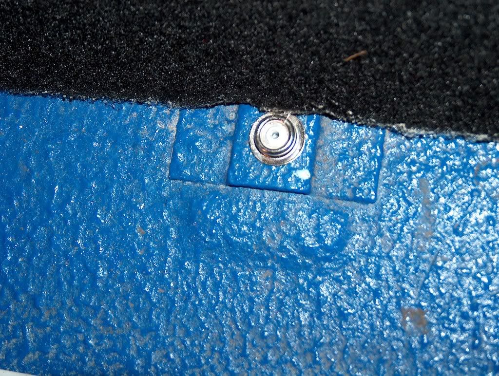

Glue for the inner sills, wheelarches, the crossmember piece(s) and the upper part of the bulkhead behind the heater. If you have sound deadening felt, glue this to the car, wait for it to dry then glue the carpet to the felt. Use a good quality spray contact adhesive and spray onto both surfaces, wait for it to get tacky then put the two bits together. Make sure you get the carpet in the right place first time, though. You can get popper type thingys to hold the floor sections of the carpet in place - this is the stud bit that gets riveted to the floor:
