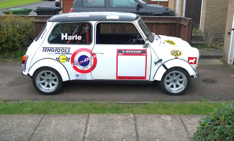

edit. i know that mini miglia cars are very different to road minis but how do they get away with being so low yet not rub arches
because they race on a flat circuit, for mine (which are mini7 spec dampers) they're set on full race track mode i.e. 100% stiffness so they don't bottom out on the arches;

v.nice mini mate i guess cutting is the only way then thanks lee
Cheers :proud: yeah, i had to cut mine away too, it's not an unusual thing, especially running on 13s ;)
