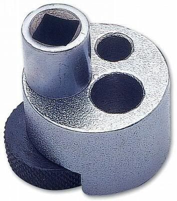

Has anyone had any use with this type of stud remover? how do they work?
They work very well, a concentric wheel grips the stud and turns it. Bit of a bugger to get the stud off the device when its come out sometimes, need to put it in a vice at times and twist the other way, but good and easy.

cheers :D, the lucky thing is, i have got one of these in my tool box and i didnt have a clue what it was :crazy:
Ill give it a try tomorrow and see how well it works.
