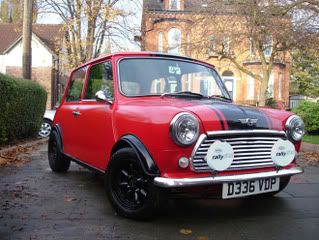

i really want to put a set of these on my mini but not quite sure how there attached to the front of the mini of how the lights are attached to each other...if you get me??
im looking for some close up pics of how there mounted and the brackets used. if anybody could help id be very greatful :D
see pics below of an example
cheers!

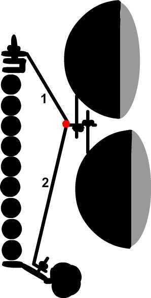

Yeah i want these too. Heres my diagram i drew of how they fit. Just make your own brackets is the cheapest way. I couldn't find anywhere making them specifically for minis though. I found ford ones but they were about £90 a set. Theres pretty easy to make - consisting of 4 strips of about 4mm thick steel, bent into position in a vice. Holes drilled throughthem in revelant places then welded together with the addition of a flat mounting plate.
As you can see the just bolt through the slam panel and the front panel. The red dot represents welding - to weld parts 1 and 2 together or you could make parts 1 and 2 from one piece of metal then weld on a flat piece. Don't be put off if you dont know how to weld - I dont and was just planning on getting a local welder to do it for me.

ahhhh Thanks asteroth! Saloon and clubman fittings and there onky £27.95 inc postage!
Only thing that puts me off with them is that there very high mounting. Judging by those pics the top set of lamps would be sticking up above the bonnet!
