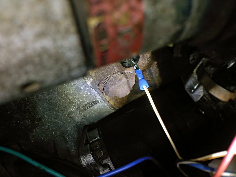

is this the fella?

no thats the oil pressure relief valve cover nut which is on the front of the block
around the same place but on the back/exhaust side of the block

thge 2 plates you are talking about are the tappet chest covers. dont undo these otherwise you will have to replace the seals. the plug is located right under the clutch slave cylinder on the block.
