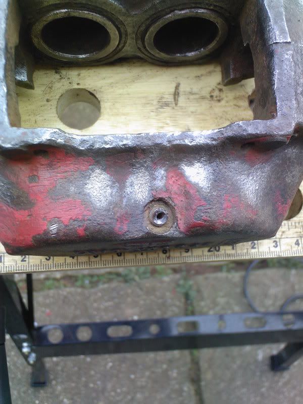

:lol: whilst working on my newly acquired metro 4 pots one of the bleed nipples has sheared off when i attempted to remove it, i'm not that overjoyed by it happening but i cant say i wasnt expecting it, how can i remove this bit? i hope its not a drill through and re-tap job, becuase i think the same thing will happen to the other 5...as i planned to replace them all and completely refurb the calipers
i've also got the pistons to remove yet too, which i imagine will be frustrating

I've had a good search round but cant find anything that helps with dealing with the sheared off bleed nipple, i could try soaking it in WD 40 and using a bolt extractor i guess
has anyone had this happen to them? if so what did you do to fix it?

The only reason I'm posting to this thread rather than encourage you to use the search feature is specifically to counter the "easyout" recommendation above. I detest easyouts and this is one of the worst place to ever consider using them. Suffice it to say, the part has sheared off in a tapped hole and the idea of easyouts is that you drill out most of the remaining part and screw the easyout into what's left to extract it. If you break an easy out (very easy to do with small diameter ones) you're really "screwed". They are hard AND brittle which makes getting a broken easy out the job of machine shops with EDM machines. That equals real money. OK, rant over.
Call local industrial suppliers. Ask them if they carry left-hand drill bits. If anyone laughs, hang-up the phone and try someone else. These are real items, just not very common. Buy a set when you find them. Also buy real penetrating oil, don't resort to WD-40. WD-40 is better than nothing but it is not a real penetrating oil. Soak the caliper/nipple with it, apply a bit of heat, then go away. Come back apply more oil and heat, then go away. Do this for as long as you can stand to wait. Give the oil time to wick into the threads.
Finally fixture the caliper where it is SECURELY held. Clamp it to your bench or something so it can't move. Then, use progressively larger left-hand drill bits to slowly drill into the bleed nipple's bore. GO VERY SLOW. Borrow a variable speed drill if you don't have one. DO NOT drill too deep. Check your depth frequently. Only go as deep as the hole that's already in the nipple. If you're careful and lucky the left-hand drill bit will eventually relieve enough pressure on the threads that what's left of the nipple hangs on the bit and is backed out of the caliper. If not... keep drilling until you start to see the root of the threads breaking through with successively larger bits. Stop at this point and use a hooked probe to remove what's left of the threads.
Avoid re-tapping the caliper if at all possible. The bleed nipple must run very true in its bore for the conical tip to seat and seal. Most of the time when you re-tap the caliper you run the risk that the threads will be slightly larger than when new and the bleed nipple won't seat. If this happens, it's still not the end of the world. A member of this board gave me a method to work around this problem that could be your last resort if you get to this point without success.
If you find the threads in the caliper are badly damaged and that after re-tapping the nipple is loose, buy a new bleed nipple and go to a bearing house to buy a few loose, small steel balls. Find one that covers completely the fluid pilot hole drilled through the bottom of the bleed nipple port. Ideally, this ball will be about 1-1/2 times the diameter of the little pilot hole you'll see. Take your brand new bleed nipple and grind/file it's tip completely away so it has a flat face. Drop the ball into the bleed nipple port and follow it with the flat face nipple. The nipple will push the ball into the seat and close the pilot hole. When you need to bleed the brakes, loosen the nipple as normal and the first application of pressure will unseat the ball so you can bleed as normal.
Again, don't use an easyout. Once they break you'll be off to the machine shop. A friend of mine who used to run a shop said they had a sign up that said something to the effect: "broken bolts removed - $10, ($50 if you've already tried to get it out).

The ball bearing fix is a spot of genius, I'm pretty sure Metty caliper nips are M10x1 the same as the unions so you might even be able to use a male union to hold the ball in.
As for removing pistons - just pump them out using the car's brake hydraulics.
