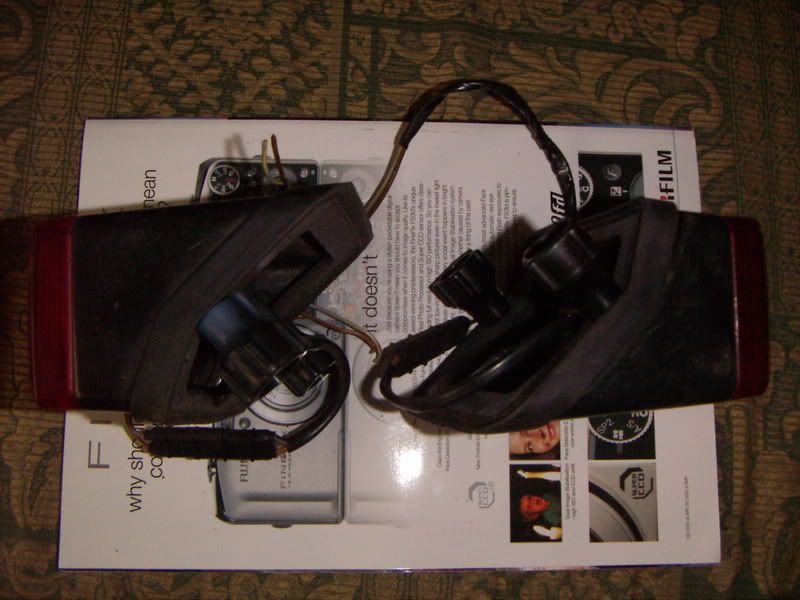

Fiesta fog lights fit the profile of a saloon rear valance exactly. You will still have to drill the rear valance but they fit flush and don't hang down.
I've got a couple going spare here (the rear valance on my estate is different so they won't fit). I'll try and find a picture of one fitted to a previous car.

Had a quick look but can't find any pics. I'll have another trawl through my pictures later and see if I can find one fitted. I can get pictures of the lights later today.

#15 minislapper
minislapper
  • 1,957 posts
Posted 03 March 2008 - 10:37 AM
