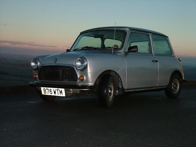

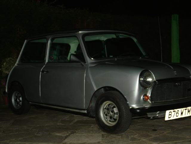

Well my mini life started on the 12 of November 2007 when i purchased 'the silver surfer'
About a week after i got the car i found i had a hole gradually getting bigger so i then changed that to a lcb with a maniflow side exit exhaust
I then found my first trip to ace cafe very uncomfortable so out came the seats and i purchased the front classic bucket seats which are now fitted to the car and i find are quite comfy on long and short journeys
Then bingley came i went to the show and ended up buying a set of wheels for 'the silver surfer' which are the dunlops and had the yoko 008 tyres fitted to them
probably the best picture i have of the wheels on the car and this is where its now

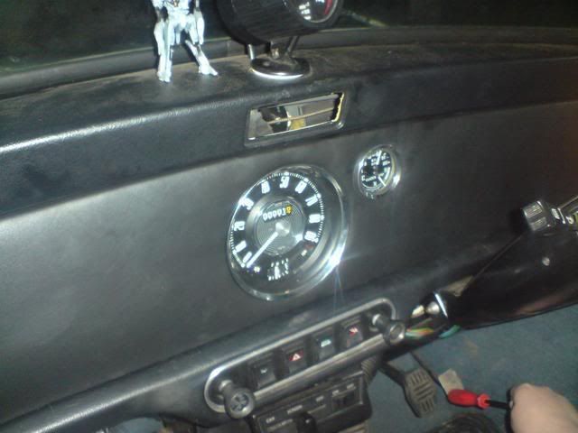

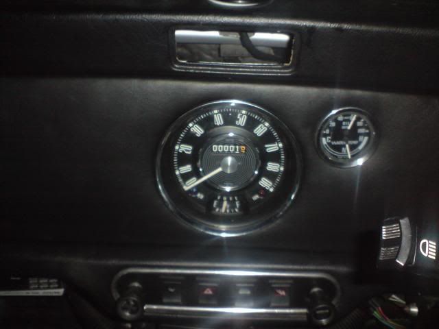

Thought a little update wouldnt go a miss ive finally finished my dash tried to keep it subtle and not have to many guages it looks quite effective and i think suits the car pretty well

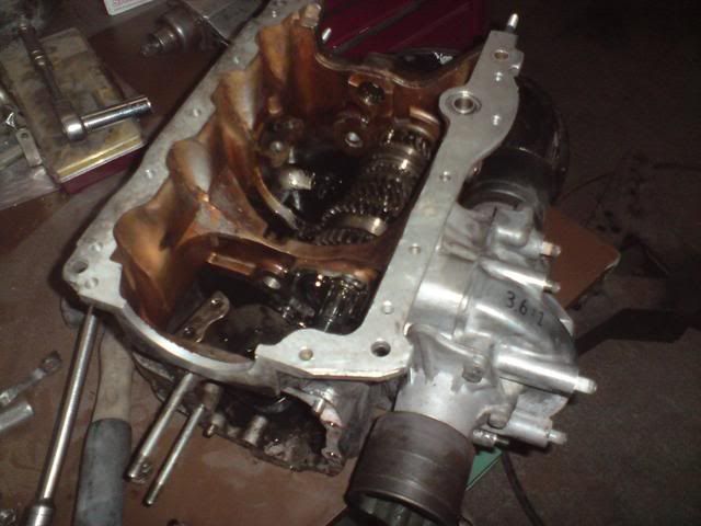

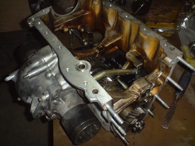

Test fit of the gearbox and mounts so i could line up and drill hole for the front engine steady for gearbox as this was ripped off on the subframe (subframe was also painted in hammerite at this stage)
The bottom of the block being tapped to 5/16 so i can run bigger bolts as the gearbox was already drilled for this
Bolting the gearbox to the bottom of the block
