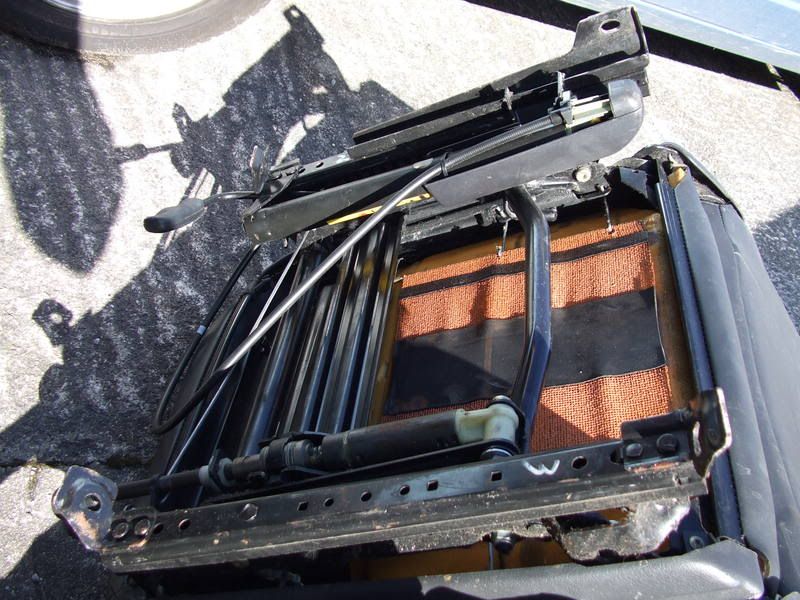

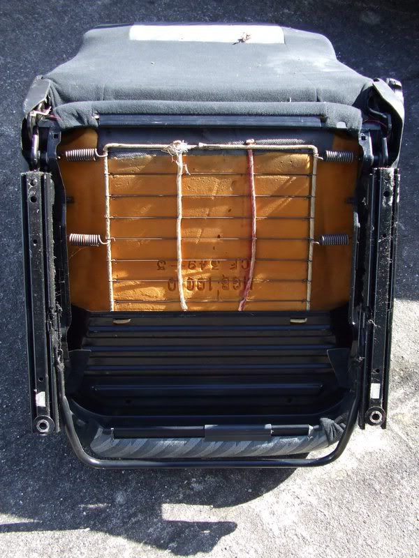

I have no idea about these seats! But any chance of a picture of the base? to see what you have to work with really as will most likely need a custom frame!

Here's the pics, they are exactly the same, apart from the base of the tomcat is very bulky and complicated! I'll probably remove the base mechanism and try to source a gti one as they seem to be a straight swap.
Gti Base
Tomcat base
