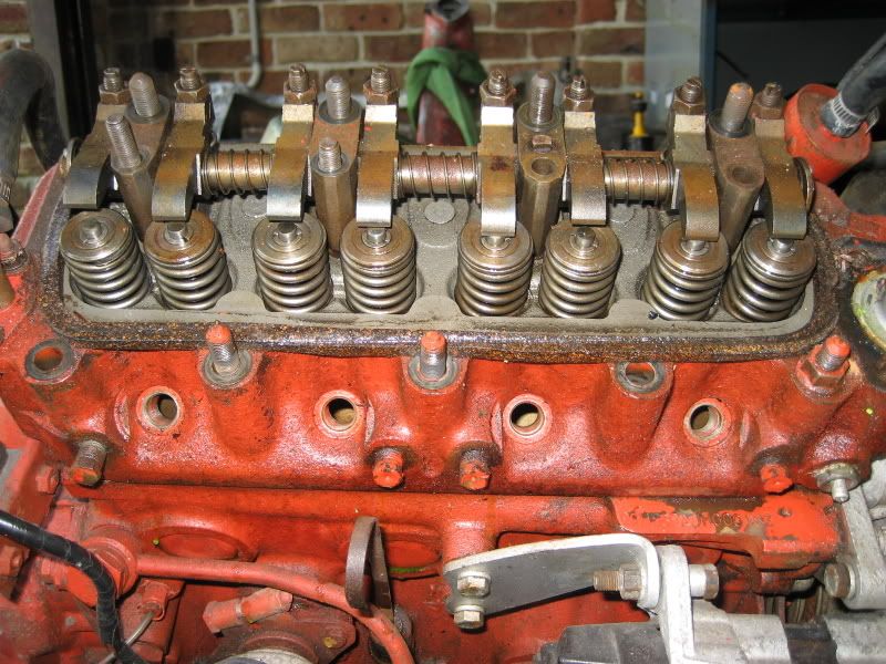

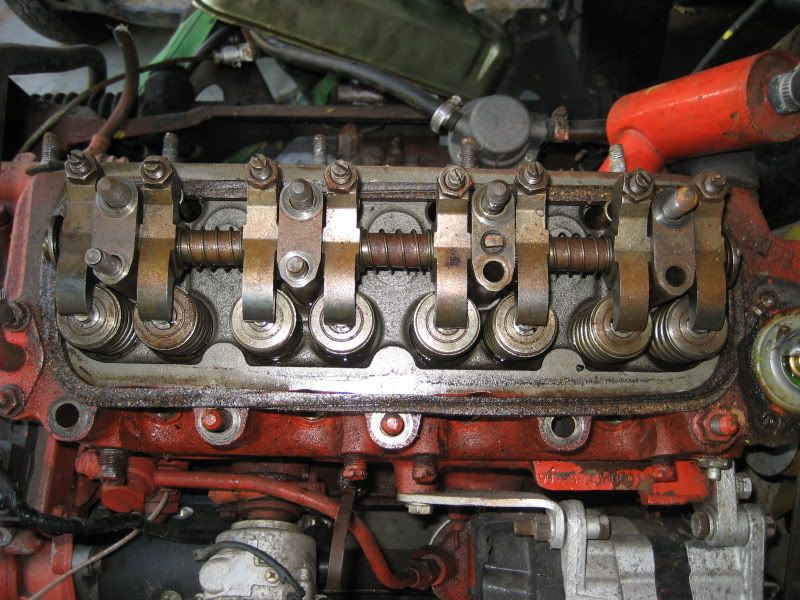

Hi just taken off all the bolts in the right order according to the leyland workshop book. so this is where i am now.
So thats all i can figure to take off althoguh the head is still not coming off, i have taken off the exhaust and intake manifold...
But so any ideas guys??? im pretty lost? Also still any ideas on how to get to the engine number??
Cheers adam
#8 partsguy1
partsguy1
  • 163 posts
Posted 10 March 2008 - 04:16 AM
Interesting Head you have there, looks like a Canadian Spec 998. The ports on the front (with the hex headed plugs in them) would be used to pump air into the combustion chambers, it was an early effort to improve emissions.
The Rocker Gear should just pop off, you may have to prise it up a little if it has been sitting for a bit. There is also one Head Stud nut you missed by the Thermo Housing. When you get the Rocker Gear off pull the Push Rods out, keep them in order so they go back in the same hole, I usually poke them through a piece of cardboard and number them 1-8. Oh, and twist them as you pull up, helps to separate them from the Cam Followers.
Once you have that done, whack the Head on either end with a Dead Blow Hammer or a Rubber Mallet............. that might help break the Head Gasket bond.
Terry

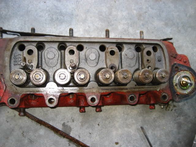

Ok ive got the head off... But i can see any numbers on the head other than on the top left...
Does anyone know if this is a head number.... ( ECAM 4004) ???
Here is what i can see ..
Is this where i should b looking on the top or am i missing somethign???
Thanks guys >_<
#14 miniboo
miniboo
    Lord of Original Thinking
  • 9,327 posts
Posted 11 March 2008 - 05:39 AM
that wont have what people know as a standard head number as it is one of the emission/smog reducing heads(yeah right) no good basically so have a look for a 12g295 head or go for the 12940 head and pocketed block.
