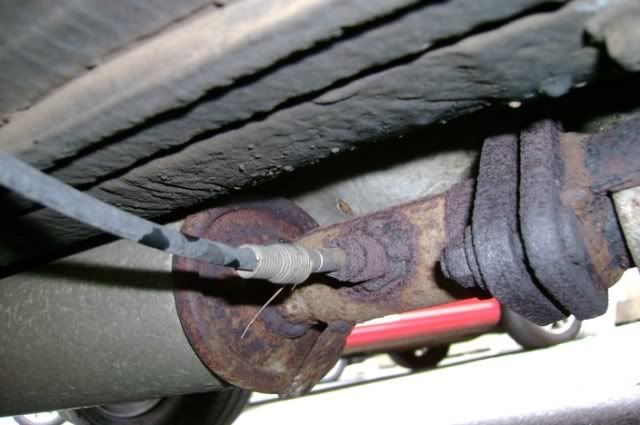

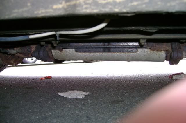

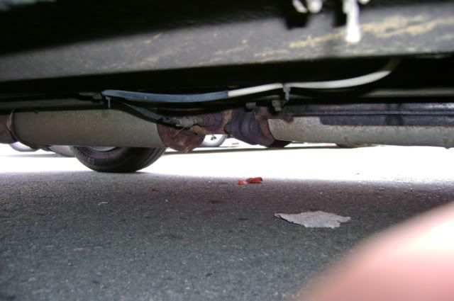

I have a reasonable idea what this sensor is, and its not the lambda sensor that controls the fueling. You will find that sensor on the manifold at the back of the engine.
Any sensor after the Cat is possibly one of two. An overheat sensor. Just a simple temperature sensor, or thermostat. Or. Its a second lambda sensor that monitors the efficiency of the cat.
I doubt its the latter, but if there is a remote chance it is, removing the core from the cat will throw up a fault in the system.
I do however think it is more likely to be the former, a temperature sensor and removing the core from the cat wont bother it.
I have no information on this as it was obviously only fitted to the export models.
While on the subject of cats, the cat fitted to the SPi/MPi mini is very efficient and unlikely to restrict the power levels by any decernable amount. I ran the standard cat last year and achieved 100bhp and 87lbft torque. There is no real need to remove it other than to make the exhaust sound real nice, and annoy the neighbours ;)
If you can tell me how many wires go to this device, we may be able to decide which it is :thumbsup:

Cool, cheers for the info. I'll try get underneth & snap a few pics to show you :P

Credit where credit's due. I rang the bloke in Adelaide, South Australia (www.brickworx.com.au). He's our local Rover Mini specialist.
He tells me this sensor is (or should be) connected to a light on the dash which tells you if your Catalytic Converter is stuffed.
It's not referenced in the Haynes manuals.

Japanese Specs 998cc carb cars have them too, as they're fitted with the cat. As Boyracer said, it tells you when the cat is stuffed and it should be connected to a light either in the dash, or in the lower right of the dashrail (where the fog light switch sits). In Japanese specs cars, this marked with red light that said "EXH" (short for Exhaust?) and will light up for 2-3 seconds when the ignition switched on. The control box is beneath the driver's seat.
This happened to me once, while under heavy acceleration at 90mph, the light goes and easing up on the throttle makes everything normal again. I don't know whether the cat is dead after that though...
