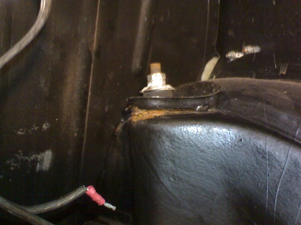

If you go for coilovers on the rear make sure you reinforce the mounts. The 3 standard welds aint enough. Here is what happened to mine:

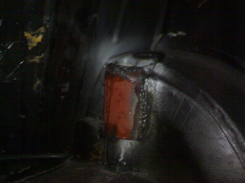

I reinforced them like this and hopefully it will help. Just done it so not sure how the reinforcement will hold up over long miles:
Some people say you need the half inch bolts on the radius arms where the shocks mount but not had problems there yet.

But those mounts were already rotten, so that would have happed with a set of normal or up-rated dampers anyway.
Well if you think all the weigh of the rear is on those 3 welds (or 6 welds counting both sides). Just a personal opinion, I think strongly, "they need reinforced". Also I dont agree that the mounts were already rotten.
