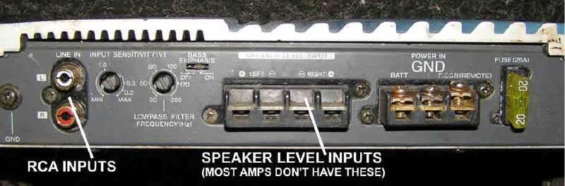

My friend just gave me a connection with four prongs which insert into the amp. He said that I should connect the two positive and negative wires to it and it will then give me the input I need... I think :huh:
Is this the part you were on about Philster?

if your amp has speaker level inputs then you just connect the speaker wires from the headunit straight to the amp. If the amp only has RCA inputs (phono plugs) then you need a speaker to RCA adaptor, you connect the headunit speaker wires to the adaptor and the the rca outputs from that to the amp.
You can buy an adaptor form here http://www.incarexpr...hp?partno=PX043
here's a picture of one of my amps.

I recon I must have a different type of speaker level input then. Its got four prongs in a connectoin about 10mm square and on to this my mate says connect the speaker wires. Ill put an image up 2moz so you can see 4 yourself
Thanks for the help though mates :huh:
