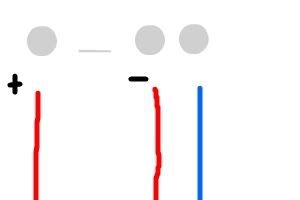

Took some wires off my amp today and can't remember which way they went back on :thumbsup:
I've got a positive and negative coming from the battery and another wire coming from the ISO plug in the back of the HU.
There 3 connections on the amp:
Which way do they go round any idea?
I seem to recall the 2 power cables being seperated by one of the unused terminals on the amp but can't remember?

Usually red to positive (+), blue to remote (+) and black to negative (-).
The remote on cable (blue) is usually always in between the positive and negative terminals on the amp.

Great Thanks.
