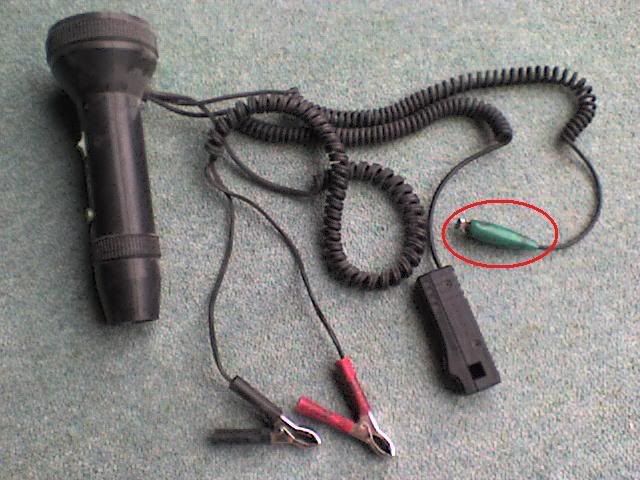

Hello,
Can anyone help me identify this connection circled in red. It is a crocodile clip type connector.
It is an Optilux branded meter if that helps.
Thanks,
Anthony.
(C**p pic off my turd phone)

Well ill try and describe it.
It has 12v battery connectors
Also a clip type to go round spark plug no.1
Also this crocodile type with shrouding that I do no know where it goes.
Any ideas?

#5 lrostoke
lrostoke
  • 6,923 posts
  • Location: Maybank, Staffordshire
Posted 19 April 2008 - 11:40 AM
If its anything like the multimeter I use, the extra clip goes on the negative terminal of the coil...
its used to get the signal from the ignition system for measuring dwell, also gives rpm as well

Posted 19 April 2008 - 11:41 AM
Cheers pal, the pic is up now if you could confirm that?

Posted 19 April 2008 - 11:45 AM
the meter is nothing like , but it would make sense it clips onto the coil.

Posted 19 April 2008 - 11:47 AM
Thanks Ill try that then.
