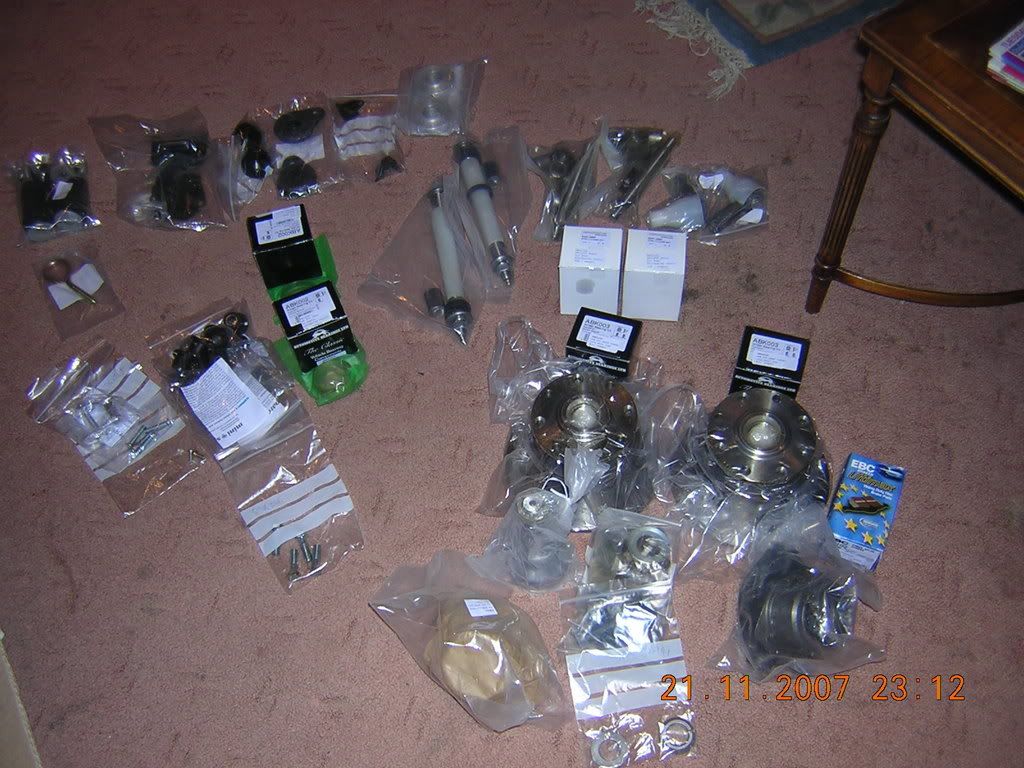

Posted 24 April 2008 - 11:01 PM
Hi..I've just fitted KAD 4pots to my mini with 7.5 discs ...................
Kad's where £300 disc conversion £500
Ibought all new parts :xxx:
