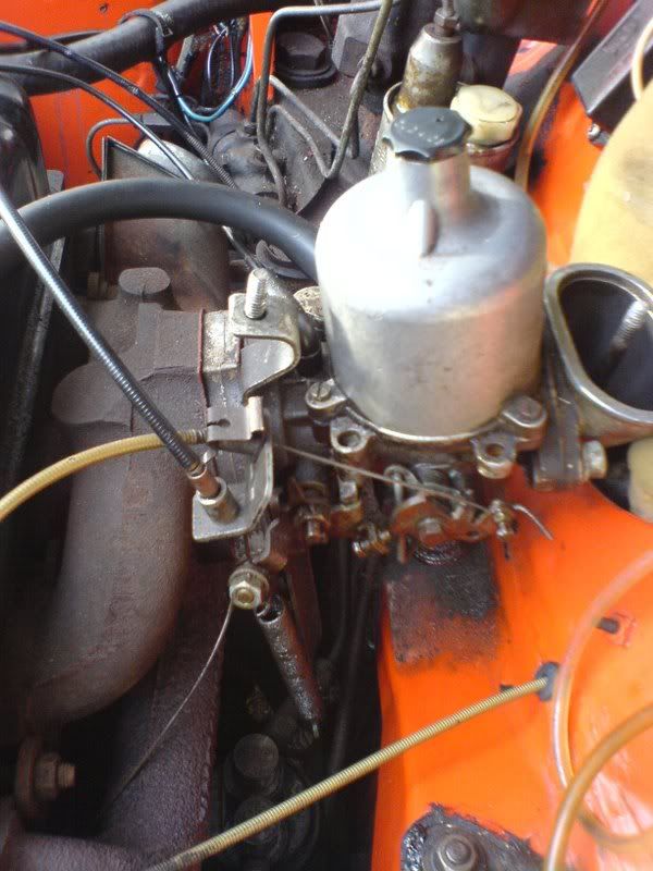

My Carb is a FZX 1142. My 850 is one of the last of the 850's produced as they began production of the 998's. According to internet sources, (Burlen and Somerford) I might have a HS4 Carb 1.5" on my mini!
Is this possible?
...Yup its a HS4! :teehee: Had me fooled! Okay so now I can buy a freeflow and alloy water heated inlet manifold :D Anyone selling either / or??

Where the carb mounts to the inlet the two studs will be vertical if HS2, Diagonal if it`s HS4
Looks like a HS4. The HS2 carbs have a longer throat on the carb bell.
Picture taken just before I fitted my new choke cable:
As you can see from the pic, it leaks petrol down the shaft and onto the body :D
Edited by Lund, 21 April 2008 - 06:30 PM.

It`s a HS4

buy a service kit for the crab from http://www.burlen.co.uk or minispares to get the discount but i am not sure which will work out cheaper. i have a maniflow freeflow manifold but postage might be a killer.
