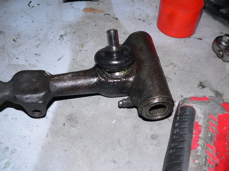

Hey guys,
I bought new knuckle joints for doing my hi lo suspension..
Although im finding it really hard to fit the knuckle joints over those ribs..
This is what they look like..
Are they fine to just leave them like that and put them in??

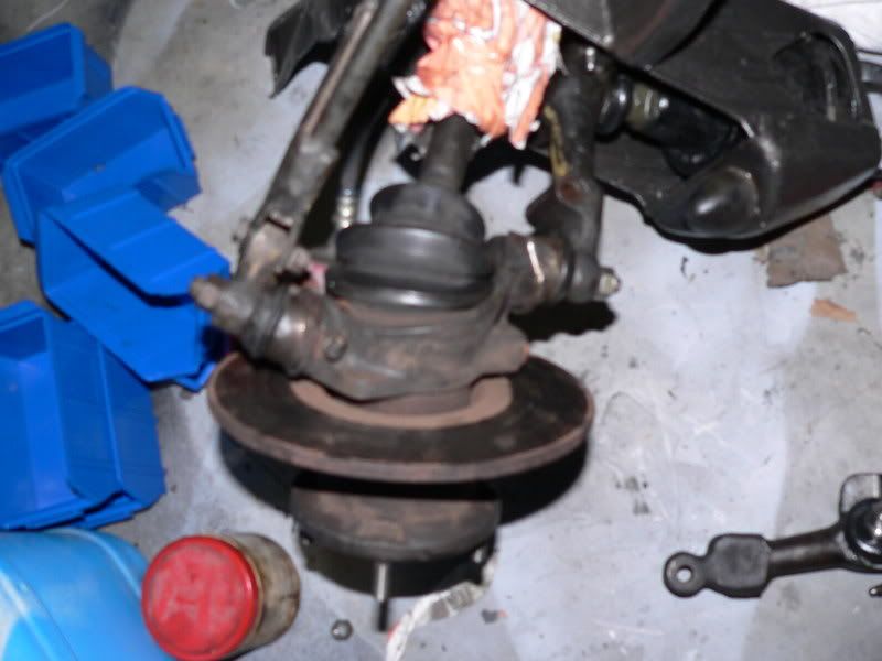

Also does it look lkie my disc brakes are put in the right way around? lol

Did you replace the plastic knuckle cup or just leave the old one in the arm? It is best to have the gaitor fitted to the cup before you fit it into the arm because this is a nightmare. It can be done though, and you really should get the gaitor fitted. The knuckle won't last long without it. Try to get the rear part of it (closest to the arm shaft) fitted under the cup rim first, hold that in place with a small screwdriver and then rotate the knuckle pin in a large circle. It should push the gaitor ahead of it and you can clip it under as you go. This is how I do it when I have to do it on the car, it will be easier for you as it's not fitted. You'll be best off with the arm in a vice.
There is something wrong with the disc, it should be much closer to the hub than that.
It seems that you are another person who has taken the easy option of fitting the front tie rod bolt into the bottom arm from below! PLEASE correct this, it is dangerous. It is part of the design of the suspension that this bolt is fitted from above so that if the nut comes adrift while you are driving the bolt cannot fall out. As in your other thread, my apologies if it's just the photo making it look like this.

Regarding the rubber, I turn it inside out then fold it over the cup a bit at a time.
Good spot, yeah I agree. If the nut comes loose the bolt will drop out and the tie bolt will seperate from the bottom arm. The wheel will fold back into the arch, You will loose all steering and most likely have a nasty accident. Please swap the bolt over
Im not quite sure what your talking about..
I definatly want to fix this can you please point out what area your talking about in that picture??

This bolt needs to be installed in the opposite direction that you have done it (so the nut is on the other side)
