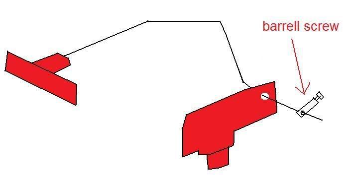

Hi Peeps.
I bought these off Minispares thinking it would come with instructions, but no. :lol:
http://www.minispare....aspx?pid=33578
http://www.minispare....aspx?pid=36941
So Basically how do these work with each other? Or am i missing something?
Thanks for any help.

here's a quick sketch, you get the pull cable and feed the smaller wire through the key hole on the end, then you slide a barrell screw on (which is included with the cable) and tighten up, that easy :lol:

Thanks Dan :lol:. Exactly what i was looking for. The little clamp was missing thats why i cant figure it out, but ill see if i can thief one off a spare carb or make one up.
