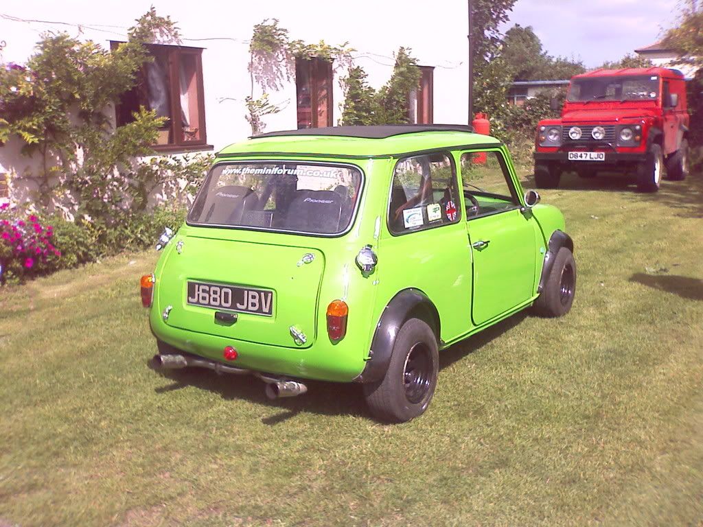

Here is mine :)

And mine:

Here is mine :)
nice mate loving the rear fog

And mine:
this is exactly what i was looking for : )

Here is mine :nuke:
Cheers mate :ph34r: Yea i couldnt think of a nice place to put the pog light an that just seemed to go there well.
The rear vallance on mine is acctually fiberglass, i had to weld the boot hinge panel to the boot floor, then i just bolted the vallance in place and filled the gap.
