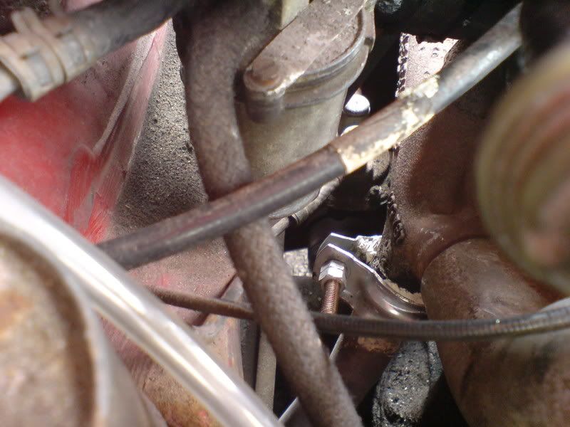

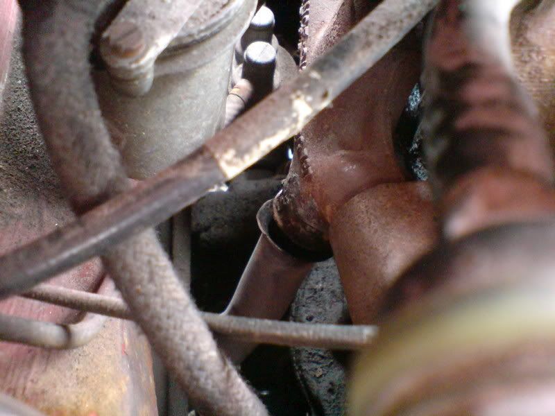

It is indeed the manifold:
Thanks for the offer Jammy, but I'm going to use this as an excuse to finally fit a stage 1 kit.
One question remains: is it safe to drive for about 35 country miles? I realise the manifold creates a lot of heat and the fact that the exhaust gases aren't being taken away...but this is the place where all my tools currently are.

#8 Jupitus
Jupitus
  • 1,479 posts
  • Local Club: Breathemini
Posted 13 June 2008 - 03:51 PM
Umm... I can't see very clearly, but has that rusted away at the flange, or is it just that you have lost this:
that would normally hold the manifold to the downpipe.... ?

It may have lost something when it decided to give up, but I thought that the bottom part had just seperated from the top part by force.
#11 Jupitus
Jupitus
  • 1,479 posts
Posted 13 June 2008 - 04:05 PM
No - on a standard system you should have one of those brackets holding the downpipe (ie top end of the exhaust system) to the manifold itself... that's fallen off, gone bump, and now you have, effectively, no exhaust system >_<
by the way - I only used a minispares pic for ease - you can get those at any motor factors or exhaust place!
Edited by Jupitus, 13 June 2008 - 04:06 PM.

Ah, I see - can't see your picture but that makes sense.
Can someone give me a link to the most suitable bracket please?

#13 syholl
syholl
  • 710 posts
Posted 13 June 2008 - 05:49 PM
You are missing one of these...
http://www.minispare....aspx?pid=38028
Not a patricularly good idea to drive it like it is, as the exhaust is no longer attached to the engine. And you can get a fine if a copper hears you...
