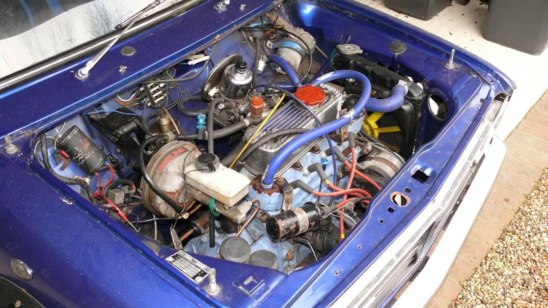

not sure what type it has, maybe you can work it out from this picture...

That's a horizontal cylinder. Disconnect the push rod on the cylinder from the pedal mechanism so you can see if the fault is in the pedal linkage. If the pedal moves freely I'd suspect the servo. It doesn't sound too major and may only need a strip and clean.
