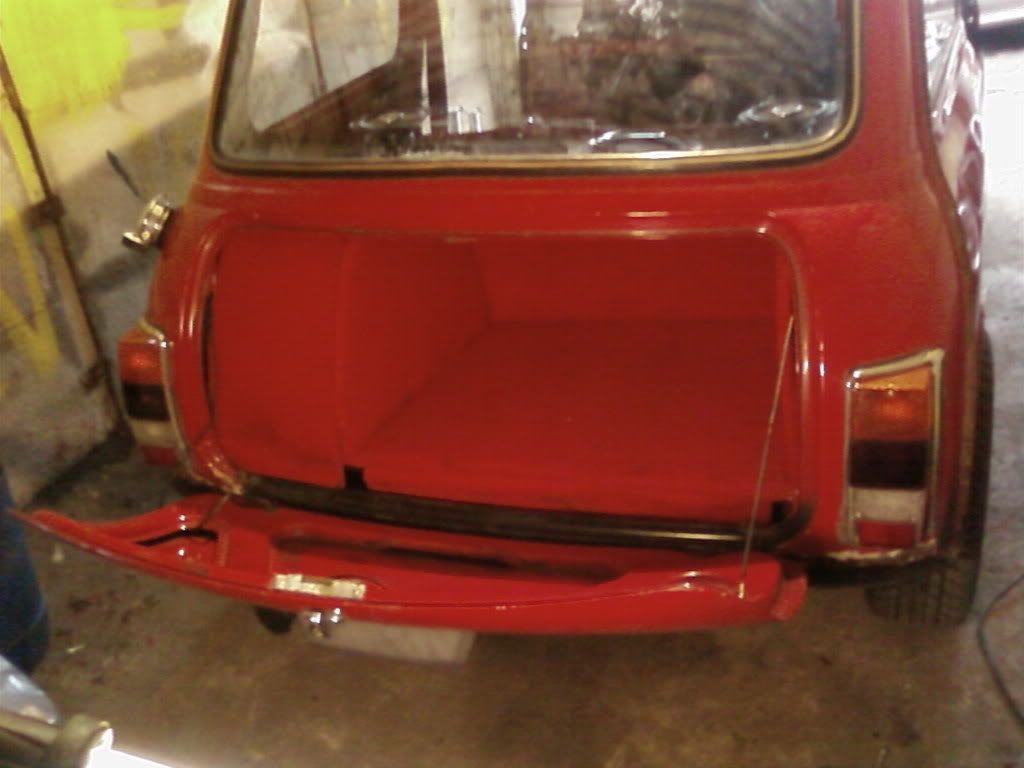

It is possible i have a 12" in my boot on this pic and i managed to fit the bootliner kit too !
and the tyres a falken 165
