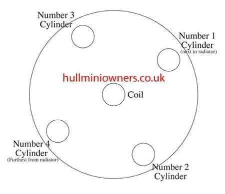

There is a diagram Somewere, but..
Starting at the dizzy cap plug at about 2:45 going ANTI CLOCKWISE, The plug order is 1342, 1 being closest to the radiator.
The contacts are the metal bits inside the dizzy cap, the ROTOR ARM, is the plastic arm thing, that goes round inside the cap but connected to the Dizzy its self. it has a metal contact on the end of it.
Make sure you clean the HT leads, infact did you swap the HT leads firsts, as it could be a faulty lead, see if swapping the non firing lead, causes the misfire to move.
#8 liirge
liirge
  • 4,097 posts
  • Local Club: EDMC AND MMC
Posted 28 July 2008 - 02:22 PM
#9 razorsharp192
razorsharp192
  • 195 posts
Posted 28 July 2008 - 02:45 PM
thanks for the diagram. yeah i tried swapping the leads, and the same one isnt firing, so its not the lead either
does the dizzy just unscrew? is there anything to watch out for when i take it off?

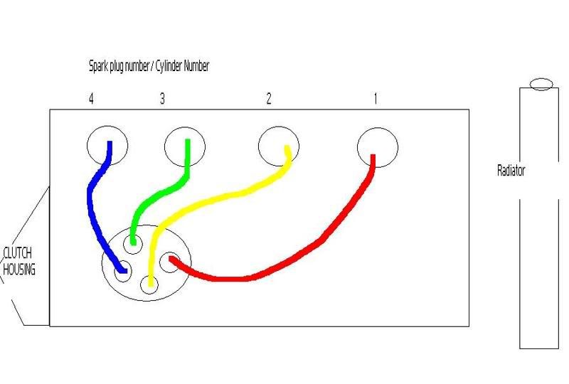

1342 is the firing order of the car, so on that diagram, "Number one cylinder" means connect it to number one Spark plug, wich is closest to the radiator. The Spark plugs, go from number 1 at the radiator to number 4 by the clutch housing on the opposite end in ascending order. i.e. 1234
#14 liirge
liirge
  • 4,097 posts
Posted 28 July 2008 - 03:19 PM
Hope this diagram i made helps
