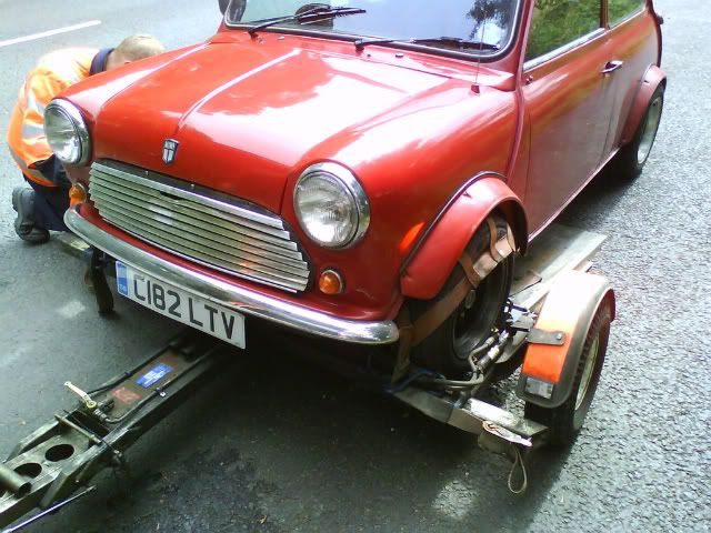

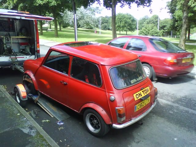

yesterday on my way to work i brokedown through overheating, managed to boil what little water i had in my engine in about 8-10 miles at 6.45am i was driving normally not thrashing her at all.
When the RAC came out to get me back on my way the guy said that he didn't like the idea of me driving anywhere in the car because after filling her back up with water and running the engine for five mins the top pipe to the rad was getting very hot plus my temperature gauge had also failed so we could not see easily what was happening with the engine temps.
fair enough i thought don't want to cause any more potential damage so got towed back home after waiting for a couple of hours finally arrived home at 11.00am.
