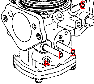

argh, where is the mixture screw on a Hif44?
#7 Sleepy Stu
Sleepy Stu
    formerly Stewart_GT
  • 2,564 posts
  • Location: Worcestershire
Posted 04 August 2008 - 09:26 PM
As you look at the carb from the front of the car its at the back on the left hand side and is pointing diagonally away from the carb towards the bulkhead hang on i might have a pic knocking around somewhere?
by the way its a real pain in ass to get to best off making a special tool for turning it! :kiss:
#8 Sleepy Stu
Sleepy Stu
    formerly Stewart_GT
  • 2,564 posts
Posted 04 August 2008 - 09:27 PM
Ah found it
Its labelled number 4 but for some reason th number 4 is backwards :dontgetit:
