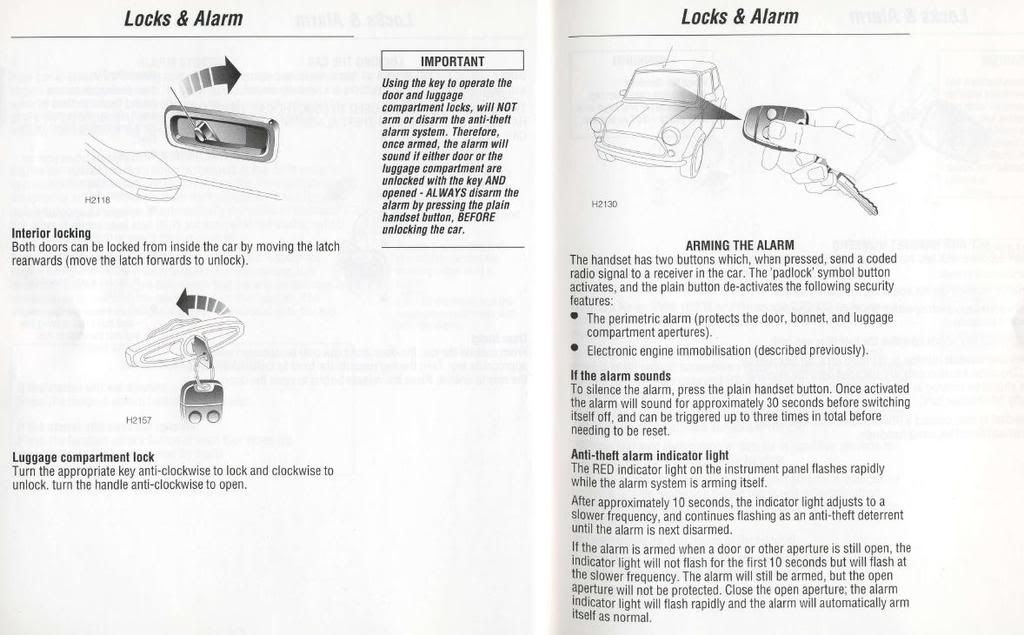

HI
could somebody really kind who has a rover mini spi 1995 onward with a 2 botton immobiliser/alarm keyfob please scan the pages from their handbook showing how to use the fob?
how to turn on/off the immobiliser
and
how to arm/disarm the alarm?
Id be really grateful :yinyang:
Ive posted another post asking about replacement fobs but if i were to get a replacment can i programme it myself?
taffy posted a link on how to do it but that said it only works with mg fobs not rover minis:(
Can anybody help?

Thanx Juju your a star;)
I checked out that link thats now gone:(
I wish it would of still been there:(
I might end up needing more pages but i have seen somebody on ebay selling new mini handbook so might buy one :wub:
