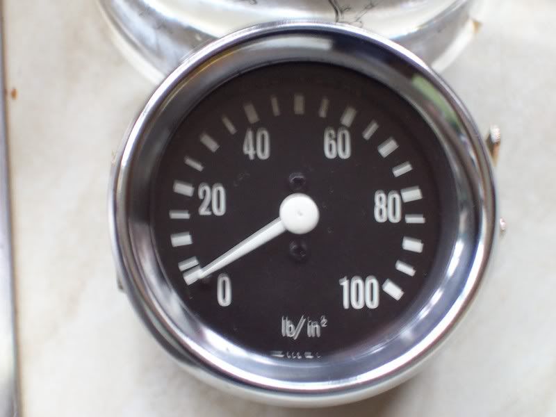

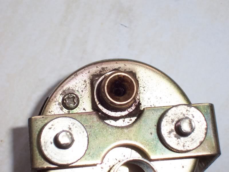

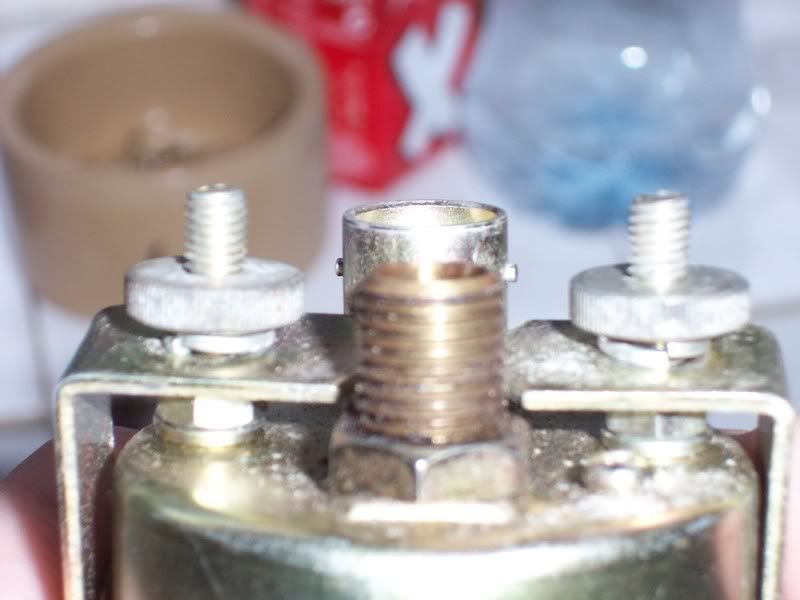

Below are pictures of my new vacuum gauage, and i was wondering what fitment is used on the gauge end...it looks a bit like a turbo gauge connction to me?
and, do you know were i can get hold of such fitment?
The gauge has the name "YAZAKI"
Any help would be much appreciated
alastair

Sorry to burst your bubble but that photo appears to be an oil pressure gauge !

Oil is slightly different, it doesnt go in in the middle, it's domed at the top. if you know what you mean

And ask for their 1 bar oil / boost gauge fitting kit . they wil post you all the kit you need to set up the gauge for about £10 i think , you get the tubing , live and eath wiring + the funny bolts to attach tube to back to guage in the centre.

That gauge is in PSI, do you know of a turbo that boosts up to 100 psi?
Gotta be oil.

The photo i can see is of an oil pressure gauge not a vacuum as vacuum is measured in inHg (inches of mercury) not psi (lb's per square inch)

oh dear ooops!
