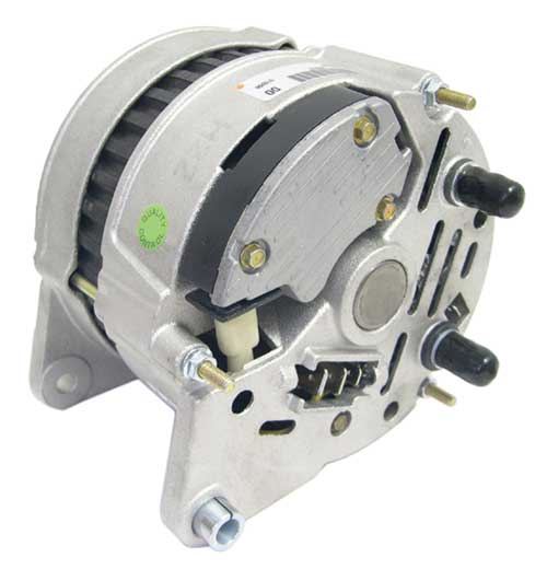

The back of the alternator should look like this:
http://www.minimania...ig/gxe2297a.jpg
I'm not sure why you have an external diode pack on your car's wiring. What year is your car? based on the picture above, you should be able to just plug the old alternator 3-pin plug directly into the A127 without any external components. You may find that your external diode is what's causing the problem.

Great work finding the pics. The first pic shows the same external "diode" (black box) that I have but the plugs are the same as the second pic and not the first. I'll try removing the "diode" first and see what happens - hopefully no damage will have been done. Then I'll make sure to remove, clean and tighten all earth connections and maybe add a new one from the block to body.
