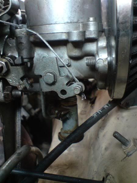

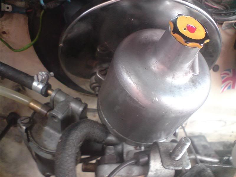

Bean, can you in your photo skills get a few pictures of your carb, including the thing pointing down under it.

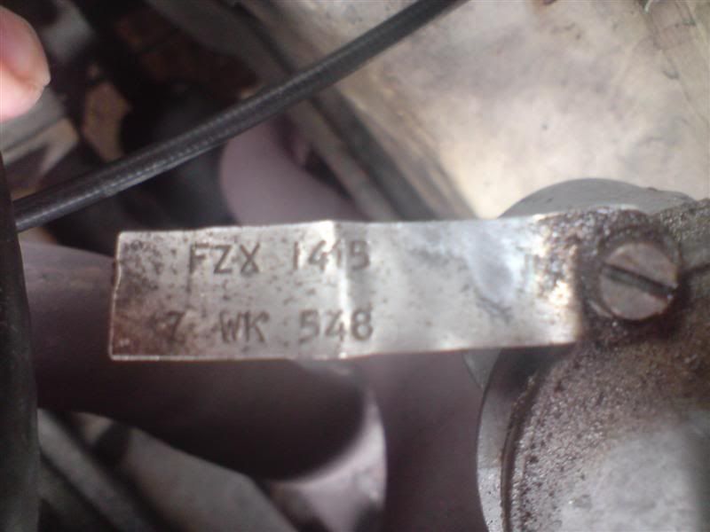

Also on the float bowl there should be a metal tag, can you get that code?

This is it:
The tag on the float bowl:

RIght well for your future referece it is a:
SU HS4 Waxstat carburettor.
from that you will be able to buy the appropriate Kit from Mini spares.
If you dont want to rolling road it, find out what needle you have got, it will have it written on the actual needle.
and they are available from Minispares and others again.
