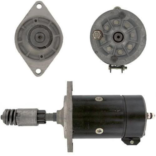

An 'inertia' starter looks like this:

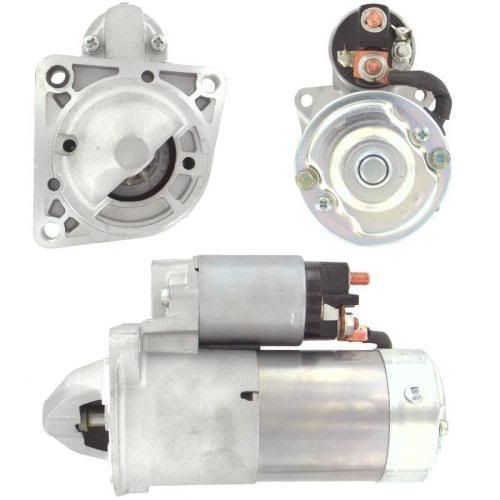

A 'Pre-engaged' starter looks like this:
Inertia starters require a wing mounted solenoid, whereas the Pre-engaged type (which was fitted to later models) has the solenoid built onto the back of the motor, as you can see from the picture.
