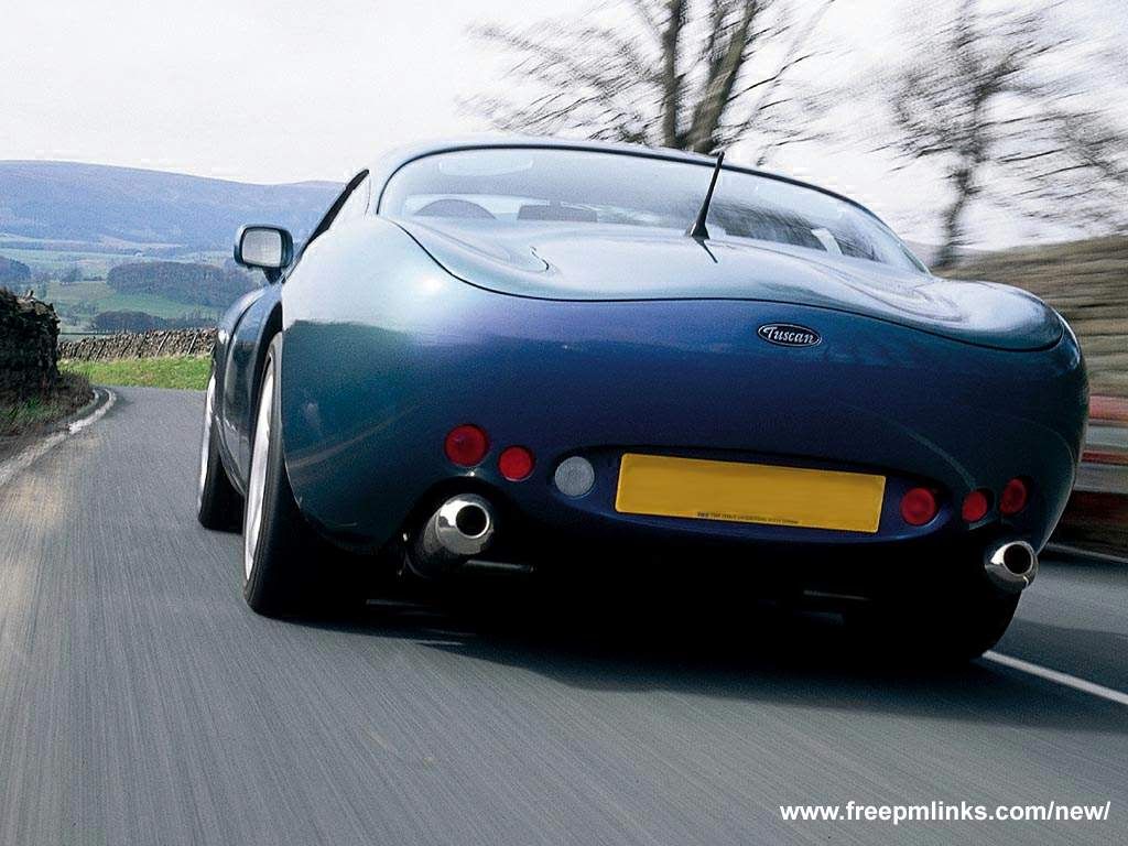

I'm pretty sure theres a TVR that comes with a smooth rear end and LED lights in the back window, can't remember what its called though.

#4 mike.
mike.
  • 6,176 posts
Posted 14 September 2008 - 12:06 PM
I know i just tryed to find the TVR i'm talking about but can't find it! I've seen a road legal punto with them in the rear window aswell once but that looked wrong...

Posted 14 September 2008 - 04:18 PM
The TVR is a Tuscan, the N/S unit is shown just above the N/S Headrest.
