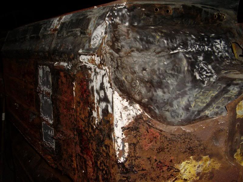

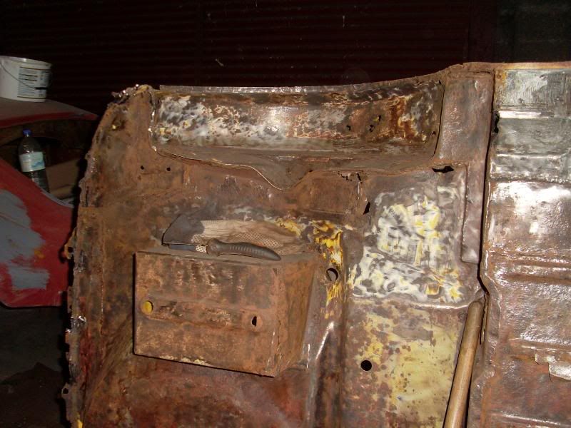

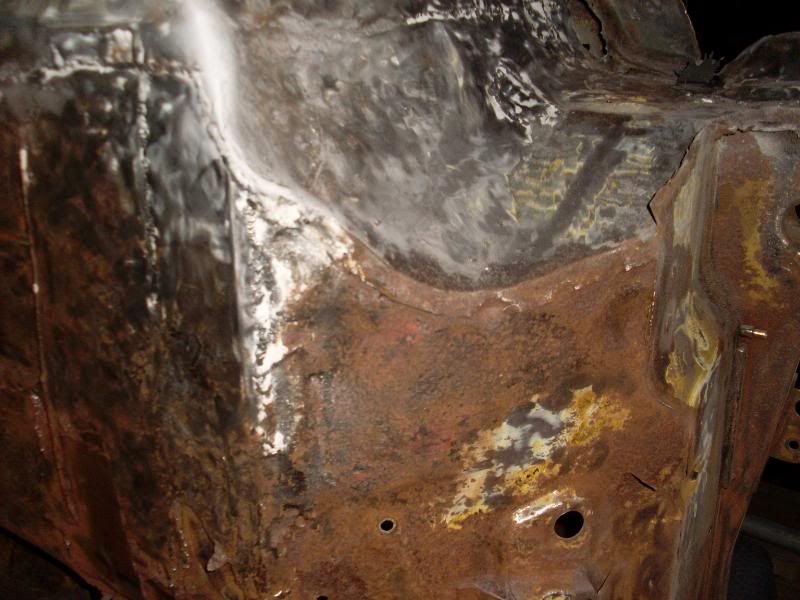

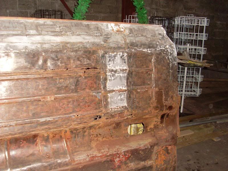

Bit of an update to this, i have the mini rolled on its side and have been stripping the underseal off the floor. From what i can see i am going to have to replace or patch the floor in several places, the boot, in rear arches and it has oversills fitted so i will replace these with genuine sills.
My question is should i get the front end replaced first then sort the floor and everything after or start from the back and work forward? If you can make out from the pics the front of the floor by the toeboard is dented and buckled as is the inner arches. would this affect which panels i replace first?

You should start in the middle of the car and work your way out. You picked a heck of a car if you are not confident with your welding. If the car is truly worth saving you should change out the floor pans. Abrasive blast the panels you keep and treat them with epoxy or etch primer. The job will be much easier with a spit.
