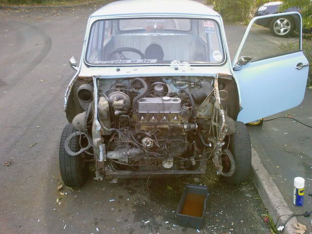

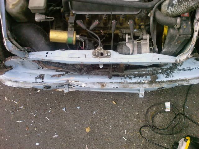

Posted 08 October 2008 - 05:41 PM
ok. bit more done today. had a go at the spot welds with a drill and was having no luck so got out the grinder again and went round them. so now have no wings or front panel:

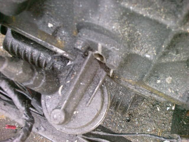

hadnt noticed but the damage to the oil filter wasnt the filter itself, but the bracket had just snapped right off lol. nice:

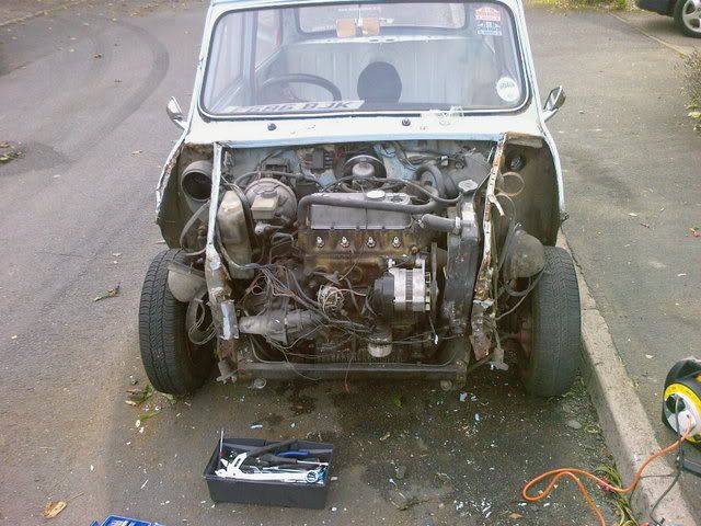

and then with some light still left i decided to take some of the little bits and bobs off the engine. horn, coil, alternator and with a bit of trouble the radiator went. so now looks like this:
its so nice and easy to get access to all the engine now its great.
so next stage would be more disconnecting of engine from car, and then to haul it out. need to find a space in the garage first though.
