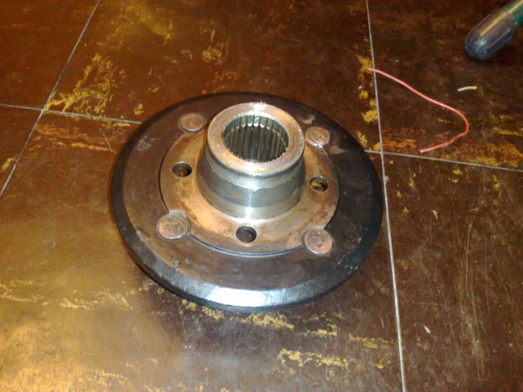

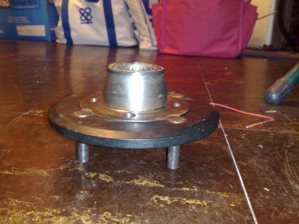

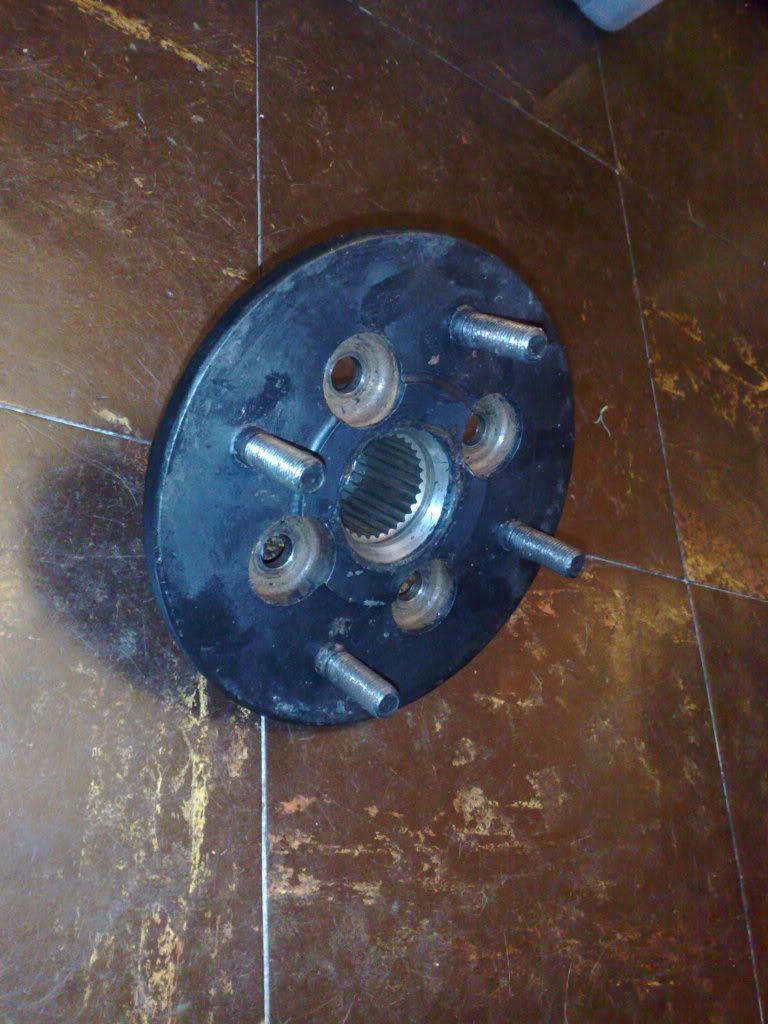

Bolted discs to flanges (after changing wheel studs for ones with flatter backs that don't foul the disc). Bolted flanges to Hub (not 150lb/ft yet).

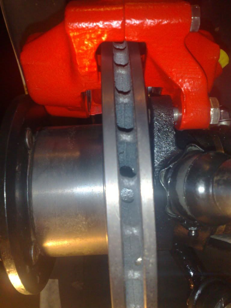

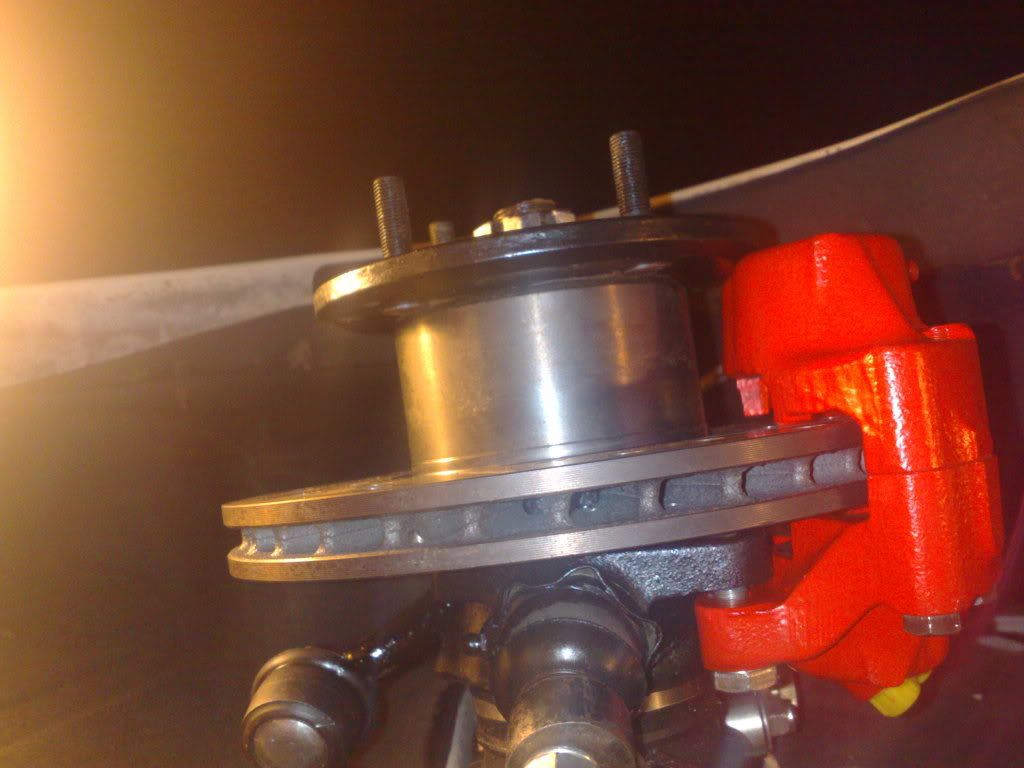

Went to fit caliper and they won't fit. I have another 4ish mm before the caliper is bolted flat against the hub, but already the outter part of the caliper is rubbing on the inside of the flange!

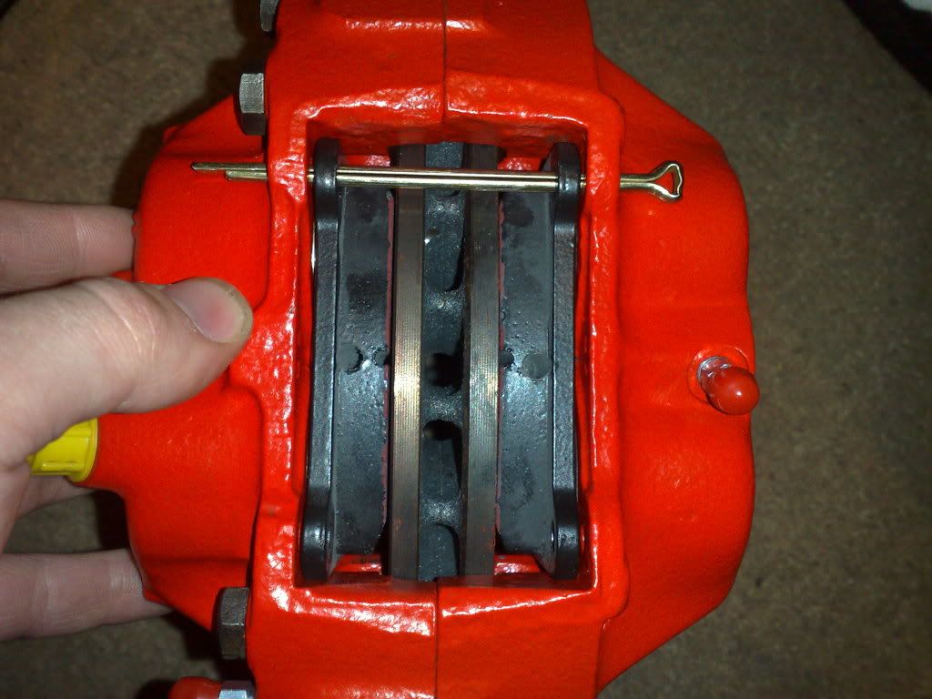

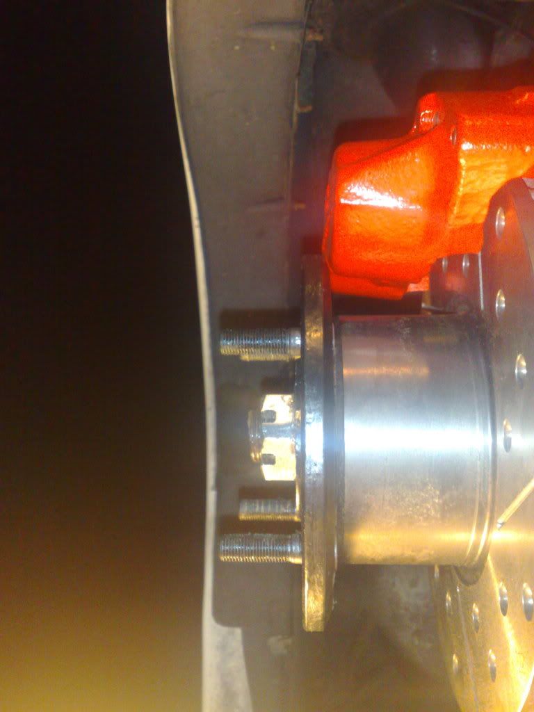

See gap right; and touching left:

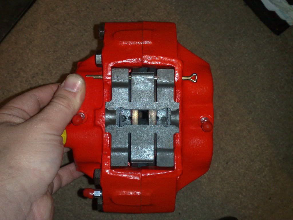

It was suggested they were non-vented calipers as there is no spacer, but they must be later vented calipers without the spacer:
So, it must be the flange I have not being a non-vented one. Has anyone got a vented flange they can measure so I can check mine?
