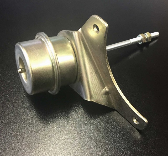

Are you talking about the wastegate or the turbo actuator?
The wastegaste is integral to the turbo, little more than a door/flap in the exhaust housing, I'd be worried if it was full of oil.
The actuator controls the movement of the wastegate (and through that the level of turbo boost), it looks (sorta) like this:
If the actuator is full and/or leaking oil I'd imagine the diaphragm has ruptured, if the diaphragm has ruptured you won't be able to control or maintain boost properly.
Sorry for slow reply. Yes that was the thing filled with oil.. plenty of brake cleaner and a kept pumping the little valve and it seemed to clear. I think the diaphragm might be ok as if I push the valve in then put my thumb over the vacuum hose it holds itself until I take my thumb off (hope that makes sense)
