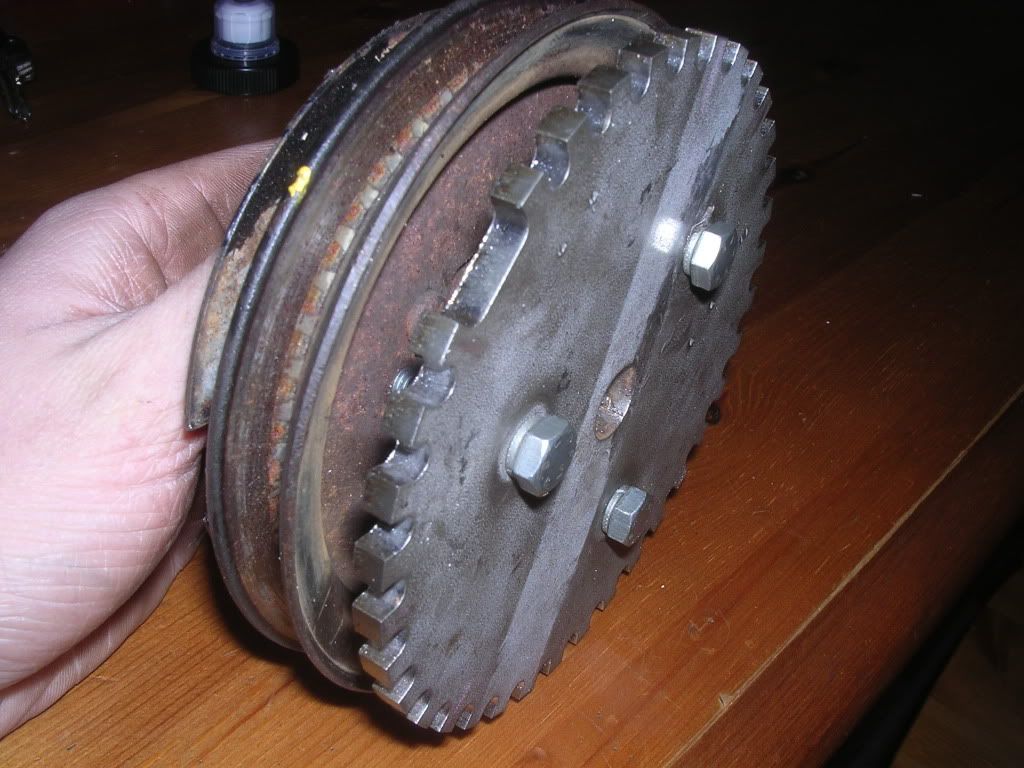

Currently rebuilding my engine and i am fitting a megajolt ignition system. I've got a new crank pulley with the trigger wheel machined into it but it doesn't have a damper. I know its meant to be there to reduce vibration. Just wondering if it will do any harm to run without the damper?

I bought a kit from SD minis a while back it came with everything. Coilpack, edis unit, ecu, ht leads, trigger wheel, sensor and sensor bracket

Is it possible to buy an aftermarket damper and fit it to my pulley because there is two threaded holes on the face. Could these be there for a damper?

I think MED do one but it's not cheap and I'd think you'd have to use their pulley

A harmonic damper is absolutely essential on the A series engine, the 3 bearing crank develops all sorts of odd frequencies that can easily destroy it.
Odd for the pulley to only have 2 threaded holes, the conventional thing is to use the Cooper S damper ring which fixes on using 4 screws not 2.
