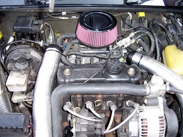

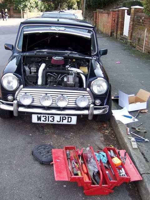

Posted 02 February 2008 - 01:28 PM
I actually did some work on my car myself!! >_< But only because one really can not find the staff these days so one is forced to stoop to the level of performing manual tasks. Oh my poor lily-whites......... :wub: :ph34r:
Induction kit on....
Not sure how useful the Doctor Who tubes are going to be, but they're shiny so they stay for the time being.

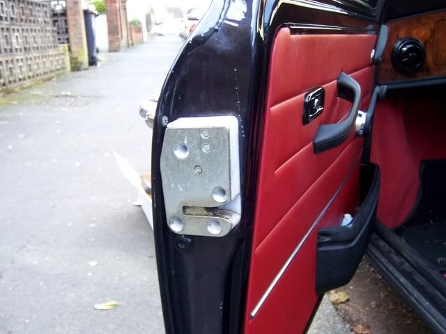

Trying to get Matilda's new door escutcheons on, but I can't get the lock out of the door. Four main screws undid fine, but no amount of wiggling will get the lock out of the door so I can get access to the crew holding the handle on. Am I missing a trick here, please? :thumbsup:

Posted 02 February 2008 - 01:36 PM
Yeah there are 2 bar connected to that lock one for the dorr handle inner, and one to lock it, both are connected via circlips, and are total gits to remove and refit.
Your have to take the door card of to start with

Posted 02 February 2008 - 01:41 PM
Yep, the latch is connected to the mechanism inside the door. There's also a screw in to the the front end of the handle. Never fitted escutcheons, but if they go behind the handle you'll have to remove the door card.

Posted 02 February 2008 - 01:42 PM
What?!! :ph34r:
Really? Just to get the escutcheons on??!!!
B*gger that for a game of soldiers. >_< I think I'll wait til she has new locks. Is there no way of loosening the handles without removing the door cards, just enough to slip the escutcheons in underneath? :thumbsup:

Posted 02 February 2008 - 01:52 PM
You should be able to slacken that screw by holding the latch out of the way with the inner door handle. But remember the front end of the handle is screwed to the door, so might not take much to dent the door by levering the handle out to slip 'em in. I'd wait if you're gonna be fitting new locks anyway.

Posted 02 February 2008 - 02:04 PM
may be best to wait till you fit new locks, if you dont fancy pulling half the door apart!

  • 3,620 posts
Posted 02 February 2008 - 02:25 PM
OKies. I don't want to interfere with her anymore than necessary, the poor wee thing.
Will do. Problem is the contrary thing has decided to make her locks work fine again. :ph34r: She has a mind of her own. :wub:
