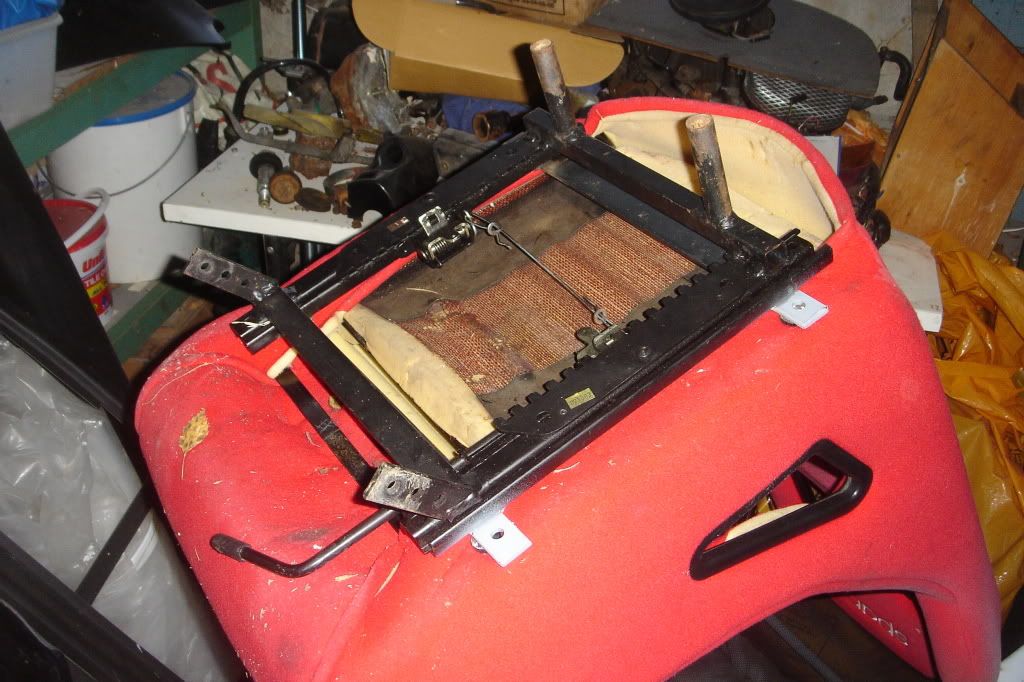

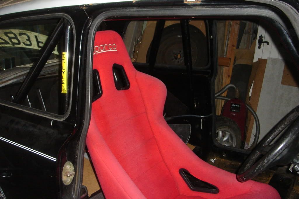

May sound like a bit of a nooby question but anyway here it is.
I bought some Sparco Sprint seats, with some subframes (the subframes were for Cobra seats but have been altered to fit the Sparco ones - not by me)
Anyway, the seats bolt in fine at the front no problem but theres nothing to hold the seat to the floor at the back - just 2 poles...
Is it meant to be like this? does your harness hold the seat down at the back? or am I missing a piece?
Heres the pics: (sorry if they are huge)
Thanks for your help!

My cobra subframes had a bracket and lever to prevent it tipping up. It was on a spring and sat underneath the upside down U bracket in the car near the tunnel.
You don't have that though, so it might have been cut off?

The earlier type seats weren't held down by anything at the back, like yours, they just tipped forwards. So it'd be ok if the seats you're replacing were that type. If your old seats locked down then you'll need new subframes, or at least to make up some kind of mechanism to lock it down with. Otherwise it's an MOT failure.

Yeah, it was a bit hard to describe but you are missing this bit, and the dude have welded on two poles:
[attachment=72778:COBSUBFR03R.jpg]
edit: didn't realise about the earlier subframes so what they said ^ ^ :D
wouldnt this mean you would be a human catapult through the windscreen if you crash?

Yeah :shifty: might be something to do with why they changed it lol. Well with where the pivots are etc etc I don't think it'd work quite like that but still, doesn't seem very safe does it??
Not strictly if you are belted up but it wouldn't exactly aid safety.
Also with those subframes you might want to check your rear floor has the bracket bolted to it that they lock into!
They aren't exactly good either, those subframes. I bought two cobra classics and put those exact frames on those, and because only one sliding mechanism (one side) locked with the seat, the seat could twist, and they could just lift up anyway :shifty:

can you not just weld a piece of box section/ flat bar across the bottoms of the two poles, and bolt it to the floor?
you loose the tipping ability, but judging by the size of the seats it would be pretty hard to get in the back if they did.
