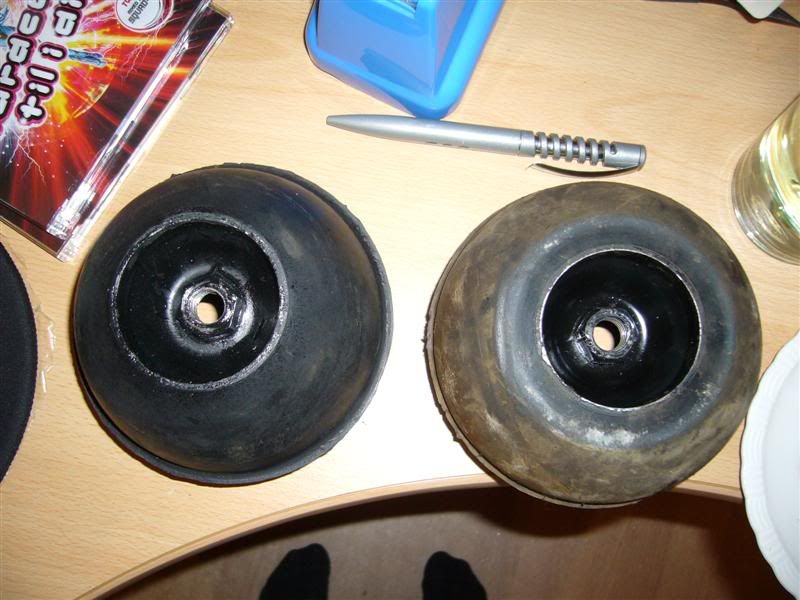

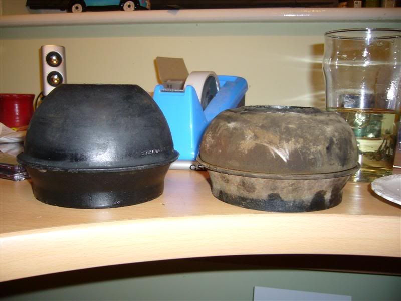

I just wanted to make an update.
all sorted out and heres the reason they were on the dump stops
Edited by ninham, 12 November 2008 - 11:27 PM.
#18 stormintrooper
stormintrooper
  • 2,072 posts
Posted 12 November 2008 - 11:30 PM
my cones arent far from that but i still have good distance between upper arm and bump stop

do u have hilos?
My knuckle joint was a bit collapse as well
But now with one side of the suspension done i have about 1 1/2 inch clearance from the bump stop.
