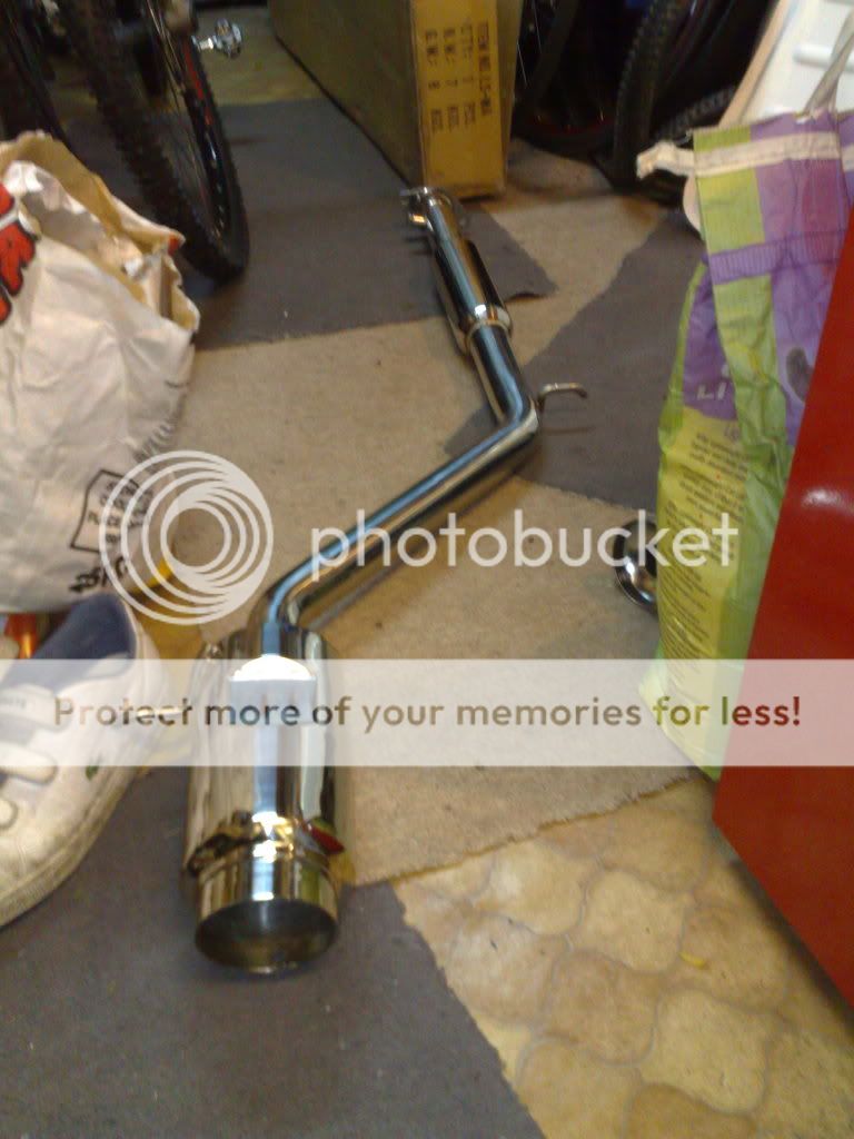

Posted 17 December 2008 - 04:57 PM
and full spec im not sure, when i got it it was overbored to 1299cc. dont know any details on this its just got ramair filter, polished inlet manifold, maniflow LCB exhaust manifold, different final drive (not sure what, was also done when got the car), 52 mm throttle body erm... lol think thats it engine wise atm but a new head and rockers is scheduled next year
and i would of said it would help...my fuel economy hasnt really changed when town driving and it picks up better higher in the rev range in my opinion...
hope this helps
edit to add zorst pic:

DEAR GOD
#13
Posted 18 December 2008 - 09:34 AM
I had a twin 3" DTM before and this is quieter and on tick over it sounds like a normal sports exhaust, only gets loud when the lead foot is dropped lol
it also tucks right up under the body so don't notice it as much as a normal one
#14
Posted 18 December 2008 - 10:32 AM
impreza's and evo's need that!!!
i have a 220bhp cooper S and i wouldn't want a tailpipe that big!!!!
my proper mini works has the john cooper works exhaust on it (twin 1'1/4) and thats cute!!!
jap stylee!!!
personally i'd have fitted the sexy playmini carbon exhaust, but each to there own i guess!!!!

Posted 18 December 2008 - 11:12 AM
and yeh 3" was big and loud lol and i was going to get the carbon one but then found this one so decided to get it
