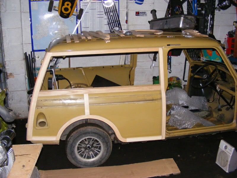

got my new wood for the rear

Looks to be pretty good quality.

That's a lot of wood was it expensive

wood kit cost around £600 . anyone know what i should treat it with ?? i was thinking about using a boat varnish.

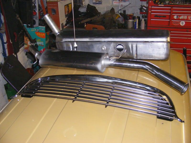

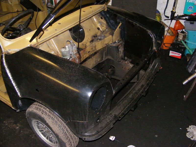

got some more work done . front end now fitted
also been cleaning up engine and rear frame
some of my new bits

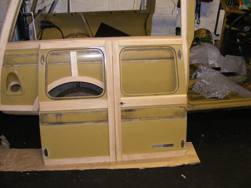

If you want to make sure the wood stays rot free get down to your local Chandlers ( boat shop ) and ask about West System Epoxy resin! 2pack
I use it on all of my boats its brilliant. nut if you want a varnish. You'll need Internaitonal 2-pack varnish (again from a chandlers) normal 'yacht' varnish in the shops is cack and fails due to UV i.e the sun.
Hope this helps

Posted 13 February 2009 - 12:16 AM
checked to see if the wood will fit ok

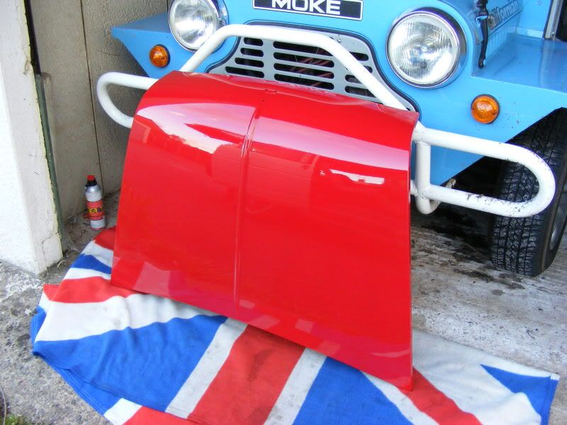

update
had the doors and bonnet painted
had to buy another pair of rear doors first as the others needed to much work
shell will be fitted with new sills and painted soon

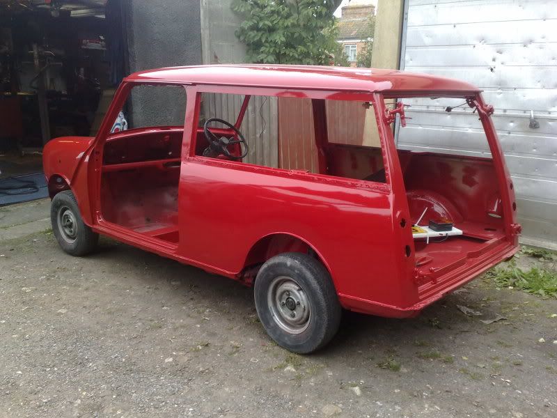

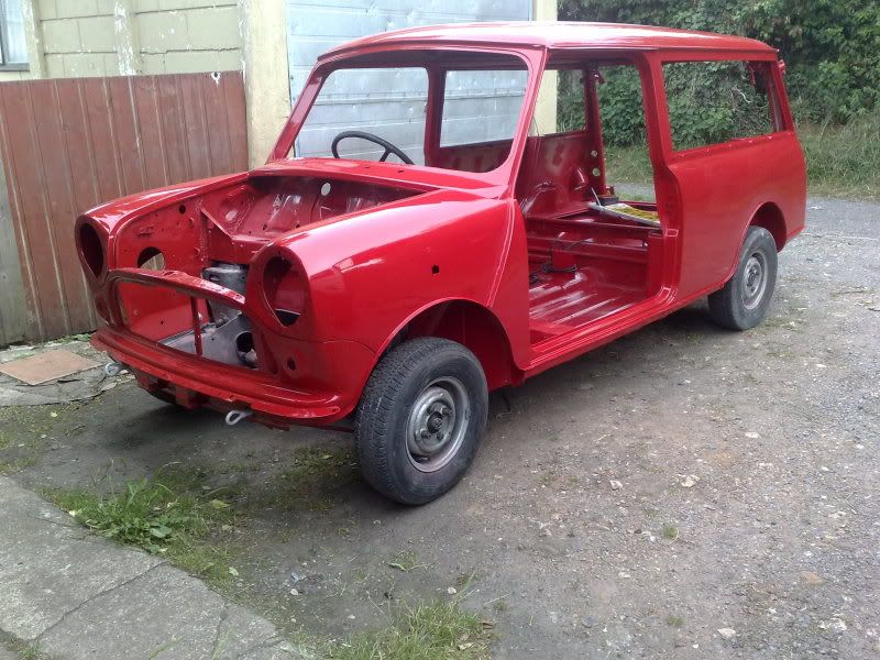

Posted 21 June 2009 - 11:19 PM
got the shell back last week
all i got to do now is put it back together

That is one nice woody!
Paintwork looks top notch as well, you must be chuffed >_<

WOW that looks mint. Cant wait to see this finshed.

Posted 22 June 2009 - 09:07 PM
Hi..A little advice from a Tradesman use PV67 sealer ansd PV67 gloss varnish this is a 2pk varnish and coat frame with sealer and then use a fine 320 grit s/paper then 3 coats varnish and then fit to estate.........this will last longer than Polyurathane..............good luck and looks stunning............... ^_^
