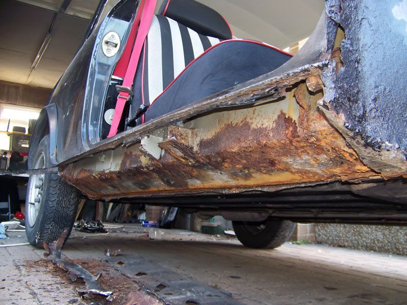

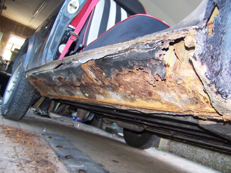

iansmini is right chap, good condition or not, those oversills are not your friend. Get them off, repair the damage they've done and get some genuine sills on it!
This was the state of mine when I cut the oversill off:
That should inspire you to get rid of them, hehe.

#6 Deathrow

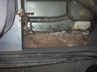

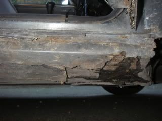

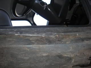

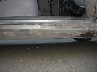

Hi I was going to post a new topic about sills but if you don't mind I'll add to this one! My son's '91 Neon has had sills patched with fibreglass and ali as per attached, at some time in the past. Can you tell from these pics whether I have oversills, and what repair panels I need? Saw some plus helpful diagrams at http://www.somerford...d-cabriolet.pdf
and of course that new chap Neil who's just joined at SC parts Group may be very useful too!
I don't "do welding" and stuff although I have done rust repairs, but have a friend with a MIG welder who has offered to help, so any thoughts or guidance, or links to previous threads ( there must be some!) would be much appreciated!

even if you don't have a welder you can cut the old ones off your self, treat any rust inside the inner sills and prep and fit the new sills with a few self tappers
leaving your mate to just do the welding
(don't drive the car with the sills fitted this way)
